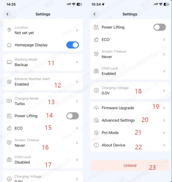

Hello, this feature can be set in the UPS settings. Please refer to position 11 in the image for the setting.
Thx, I should be more attentive. Thank You!
