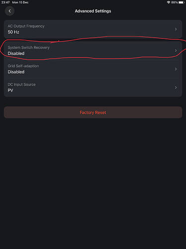

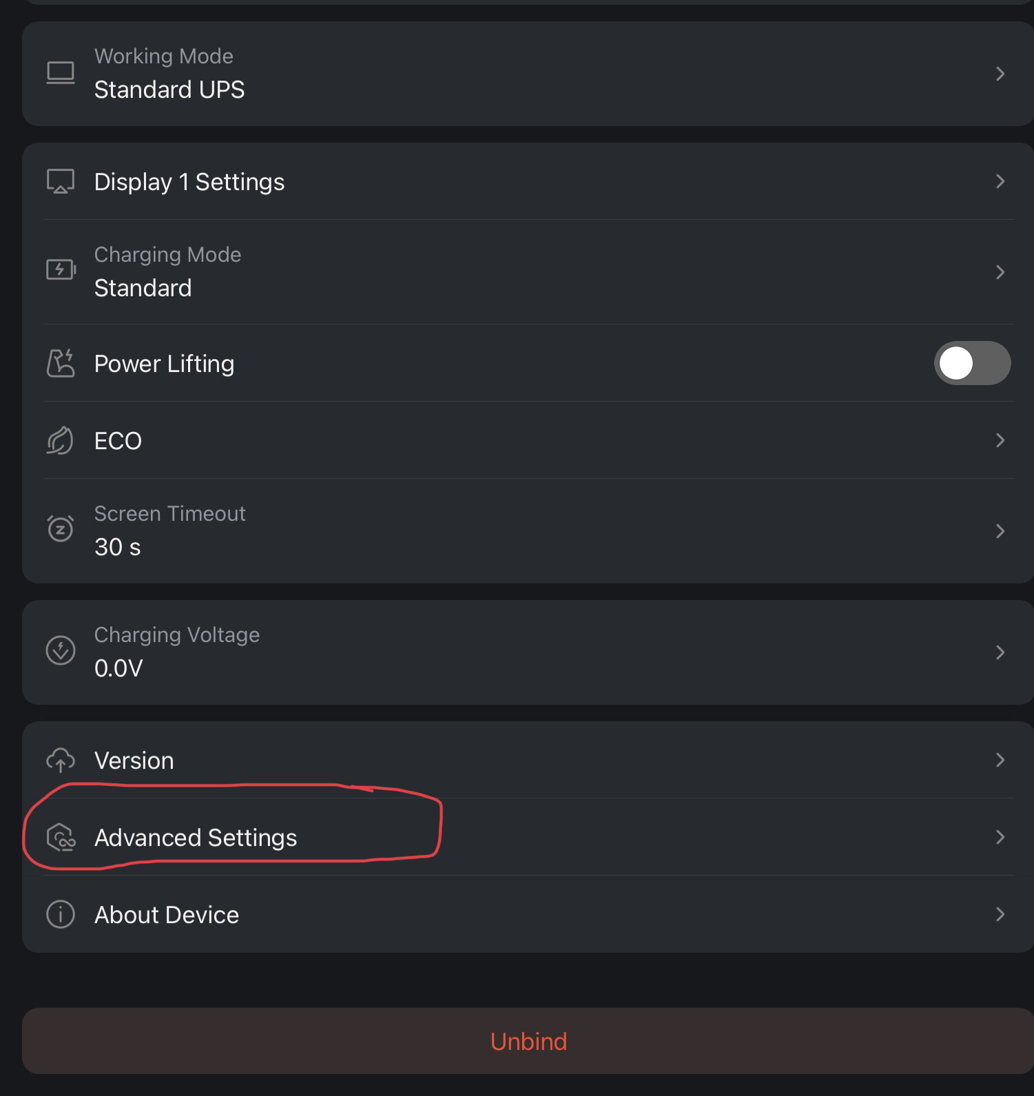

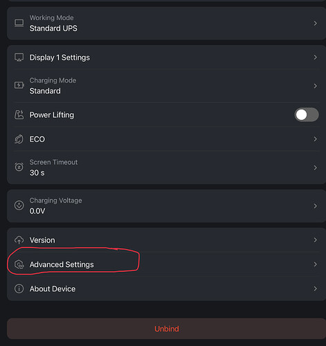

Yes you can just go to advances settings then switch recovery there you will be able to toggle on last state recovery If the battery went flat and died with ac ac or dc on when the power came back on it would restore.
