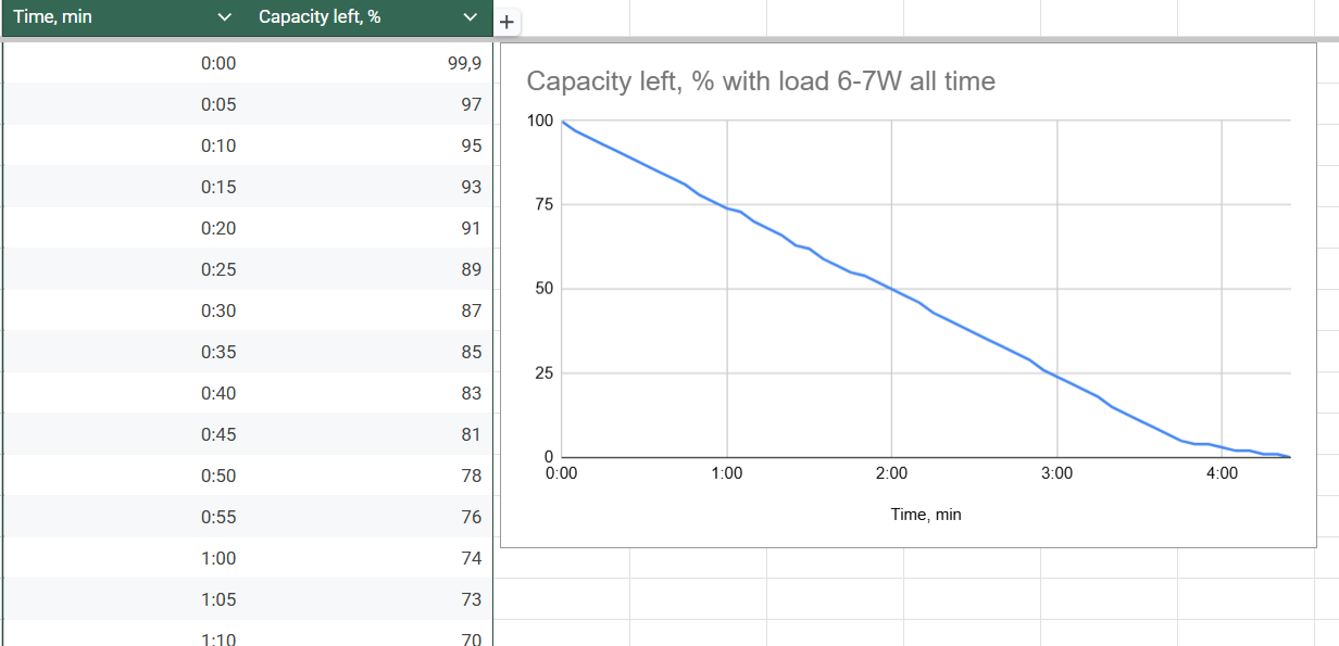

I observed how fast Elite 10 discharges and that’s I got. With average power consumption of 6-7W (as shown on the Elite 10 display during the entire observation period) it discharge in 4:25:00. But I think it should give power a twice long. If simpify calculation, with 6-7W power and 128Wh Elite’s 10 capacity it should work 128/7=18 hours. Even if concidering voltage trasformation from battery voltage to output voltage 12V, for expample 20%, so it still should be more: (128-20%)/7=102.4/7≈14.6 hours. So it look’s like Elite 10 lost a half of capacity.

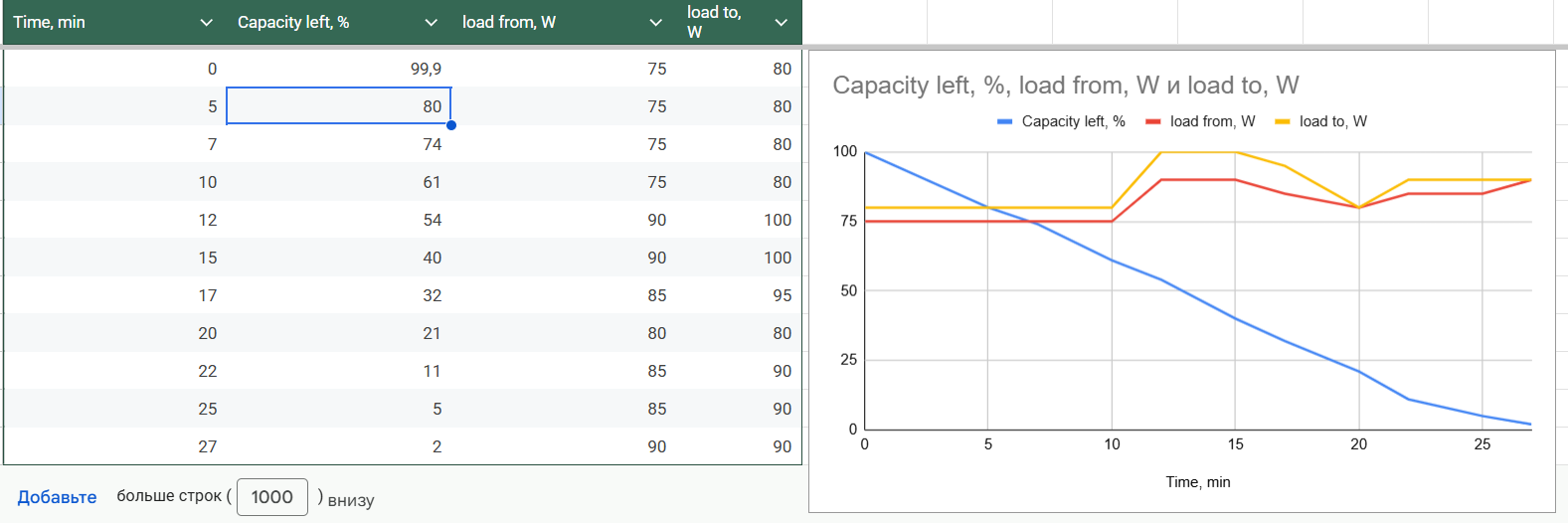

Also tested Elite 10 while charging my notebook. During the entire test I watched 1 stream at browser and didn’t do anything else, so a load on the power station should not have fluctuated.
Calculations. With average power of 80-90W from notebook (this Elite 10 showed) the power station with 128 Wh capacity yould work a little more of 1 hour, 128Wh/85W≈1:30:00. Even if substract 20%: 128-20%/85=102.4/85≈1:15:00. But our Elite 10 discharged a twice faster, in 30 mins. Here a discharge observation graph with station’s load:
