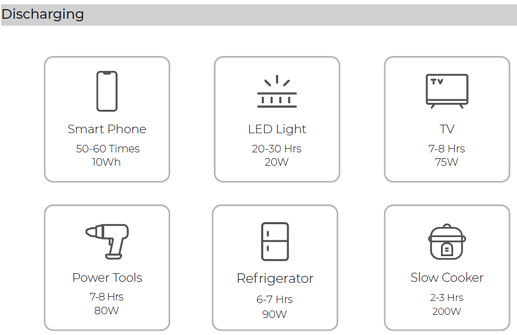

I have an EB70S and the manual shows an estimated discharge chart:

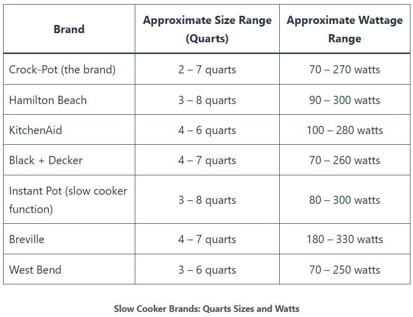

Which brand of slow cooker and which model? I found this chart of various models and the wattages they use:

The slow cooker is a 1.5 quart generic. 49 watts warm, 69 watts low and 119 watts high. I had it on low
