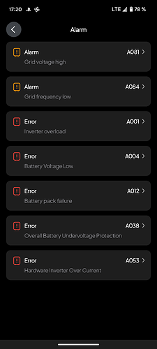

The fact that I can connect via BT to the Power station, that it went to 0% the second I plugged the charging cable and the fact that it shows A81 message as soon as I connect it to the grid tells me this is beyond just discharged.

Hi @Caesar, From the error codes, it appears that your grid voltage is very unstable. Could you tell us your general region?
Additionally, a frequency setting error might be causing the failure to charge via AC. Please confirm that the frequency matches your local power grid. Is the UPS icon on the EB3A flashing?
Furthermore, has setting it to silent charging mode helped? If you’re using a power strip, try switching to a different power source.
If the issue persists, please provide the SN number and current firmware version. We will check if there’s a new firmware available for pushing.
