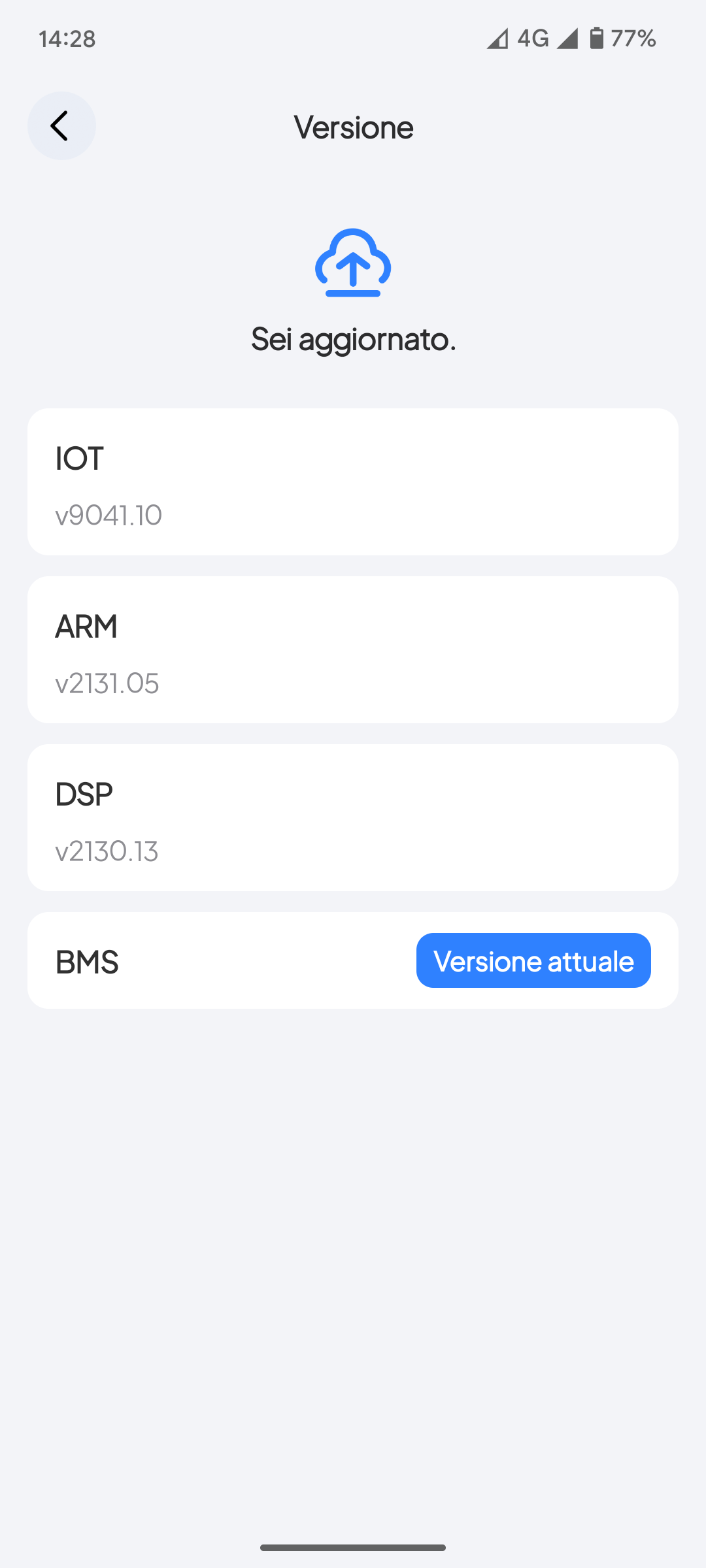

Hi,
update just done, i’ll tell you if it works.

Hi Bluetti,
actually the problem seem fixed, i can tel you better in the next week .
Thanks for the fix!
