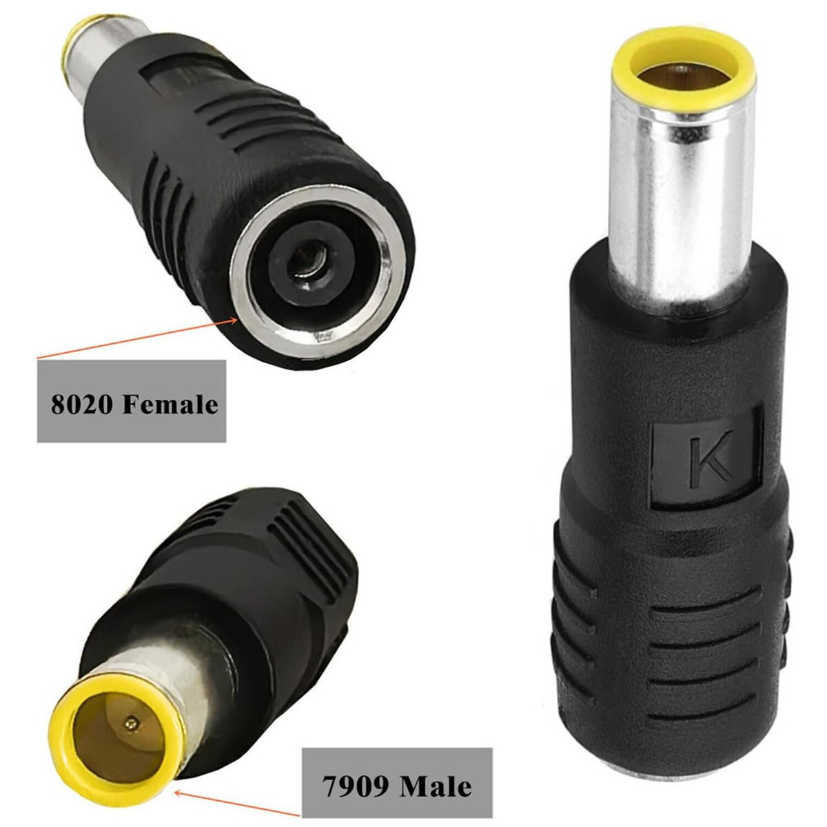

What is the centre pin in the DC 7909 plug for, and is it necessary to have it connected on third party cables? Thanks.

The center pin is the polarity and is required for connection TO the powerstation. The male pin in the center is positive (+) while the corresponding flat female end of another DC7909 cable is negative (-). You can use third party cables which use a different connector type, as long as the polarity matches up + to -, + to -, …
