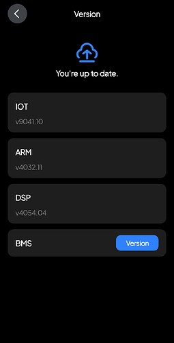

Yes, certainly, here are the versions on my AC300.
Hi @hnymann, Thank you for getting back to us so quickly.
Now I have applied to upgrade your system to our IT department. They will push the latest version of firmware to your unit in 24 hours.

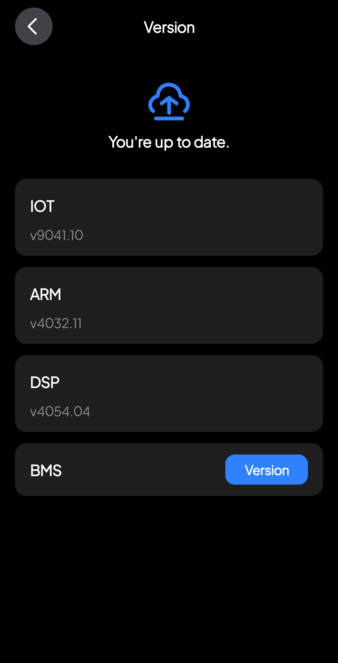

Hello, I have the same issue. I just purchased the solarX 4K and installed it on my exisiting AC300 with 3 B300K expansion batteries. All firmware is up to date and tried connecting SolarX to b300K in different ports and configuration but nothing works. It only charge the b300k when its disconnected to the AC300.
