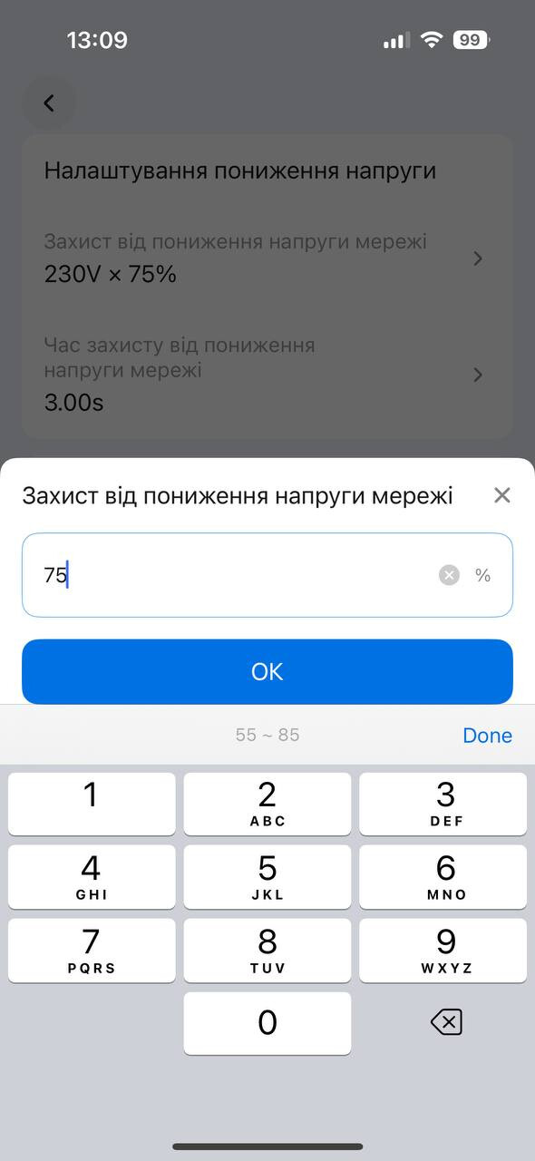

Is there some way to make my station ( Grid Self-adaption option is enabled ) charge itself when grid voltage is 180-190 v.

Hello!
I have pushed DSP212604 to you. Please update it in a timely manner. If you have any other questions, feel free to contact us.

Hello!
The new version DSP208804 has adjusted the fan strategy and relaxed the minimum input voltage from the grid to 70%. I have registered and updated the firmware for you. If you have any other questions or need further assistance, please feel free to let us know.
