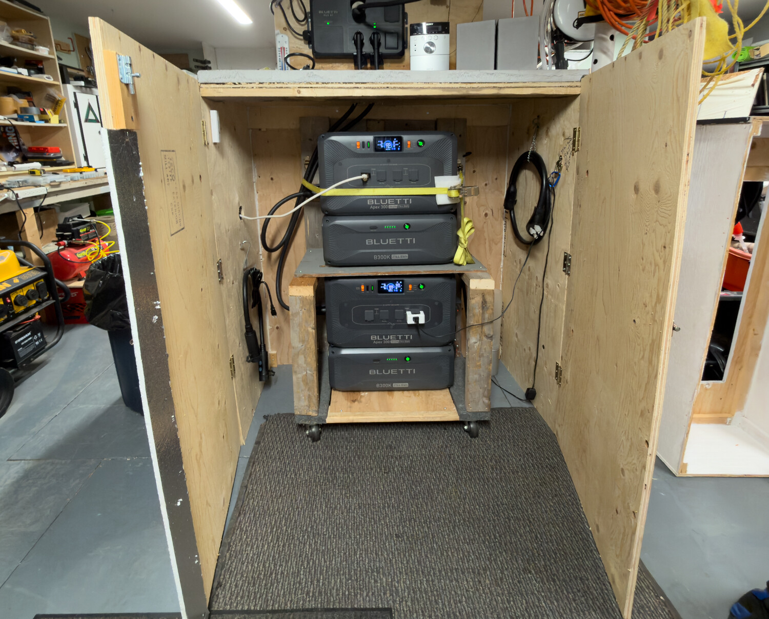

I have two Apex 300’s with each one B300K in parallel via the Hub A1. No solar panels as of now, simply a cleaner/quieter option to the generator during outages for the house.

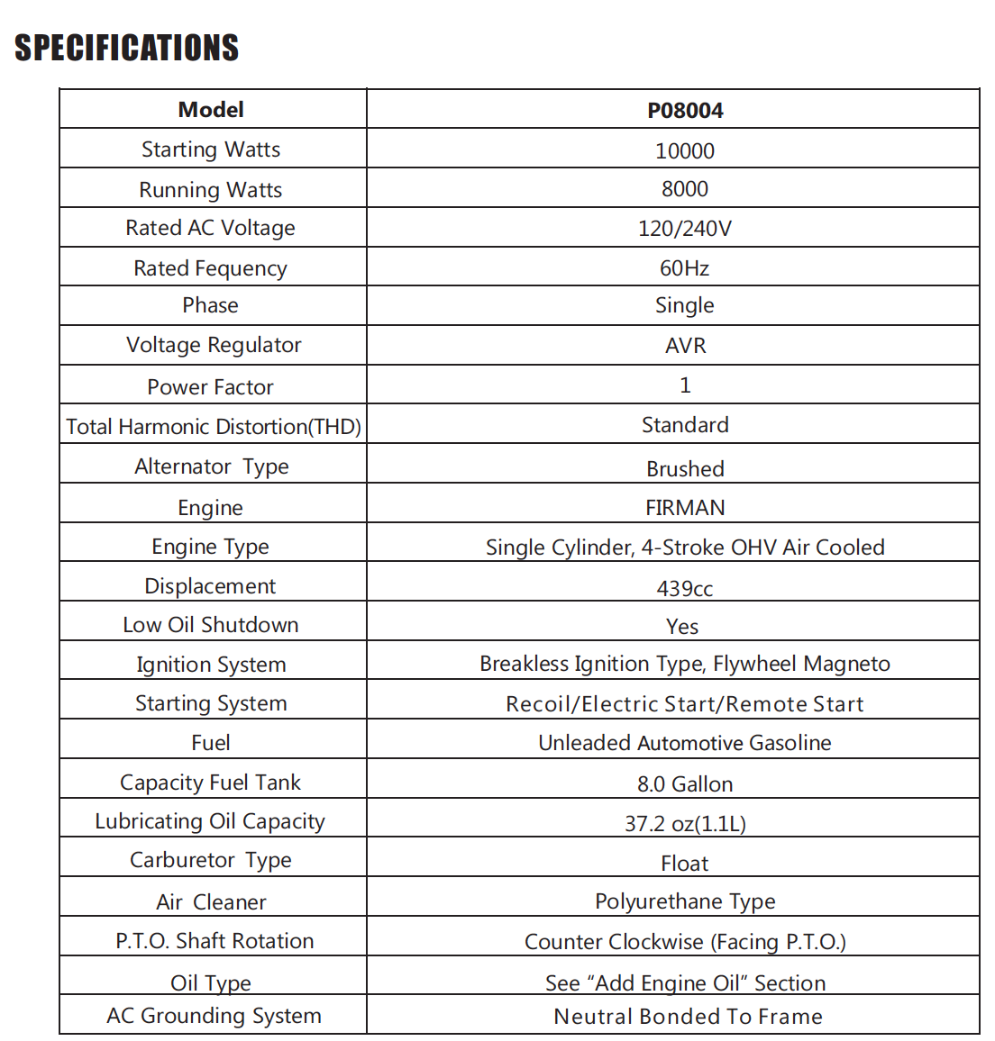

I also have a Firman 10000/8000watt gas generator (specs attached) which we’ve been using to feed the house via a manual transfer switch (30A) during outages.
Until I replace the generator with an Inverter Generator later in the year, can I safely recharge the Bluetti setup using the 120v plugged into our current Firman generator?

• Make sure the generator delivers a pure sine wave output with matching voltage
and frequency.
• Ensure the generator’s output power exceeds the Apex 300’s charging requirements.
• It’s recommended to enable the Grid Self-Adaption mode when charging the
Apex 300 with a generator.”
It does look like I’ll be needing to change/upgrade my generator to an “Inverter Generator”.
