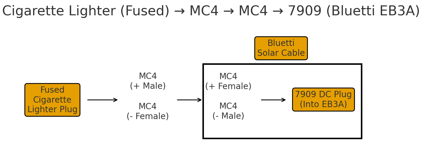

What i am trying to do now is to use cigarette lighter plug to MC4 connection and connect that to MC4 connection of solar panel cable that you guys gave us with the bluetti basically like a diagram below
it is a simple easy and safe connection i am using a cable rated for over 20amps so i should be ok, rest is simply polarity check with voltmeter and plug connection its not rocket science
There is literally 0 excuse that this shouldn’t work, i should get my plugs tomorrow to set it up
