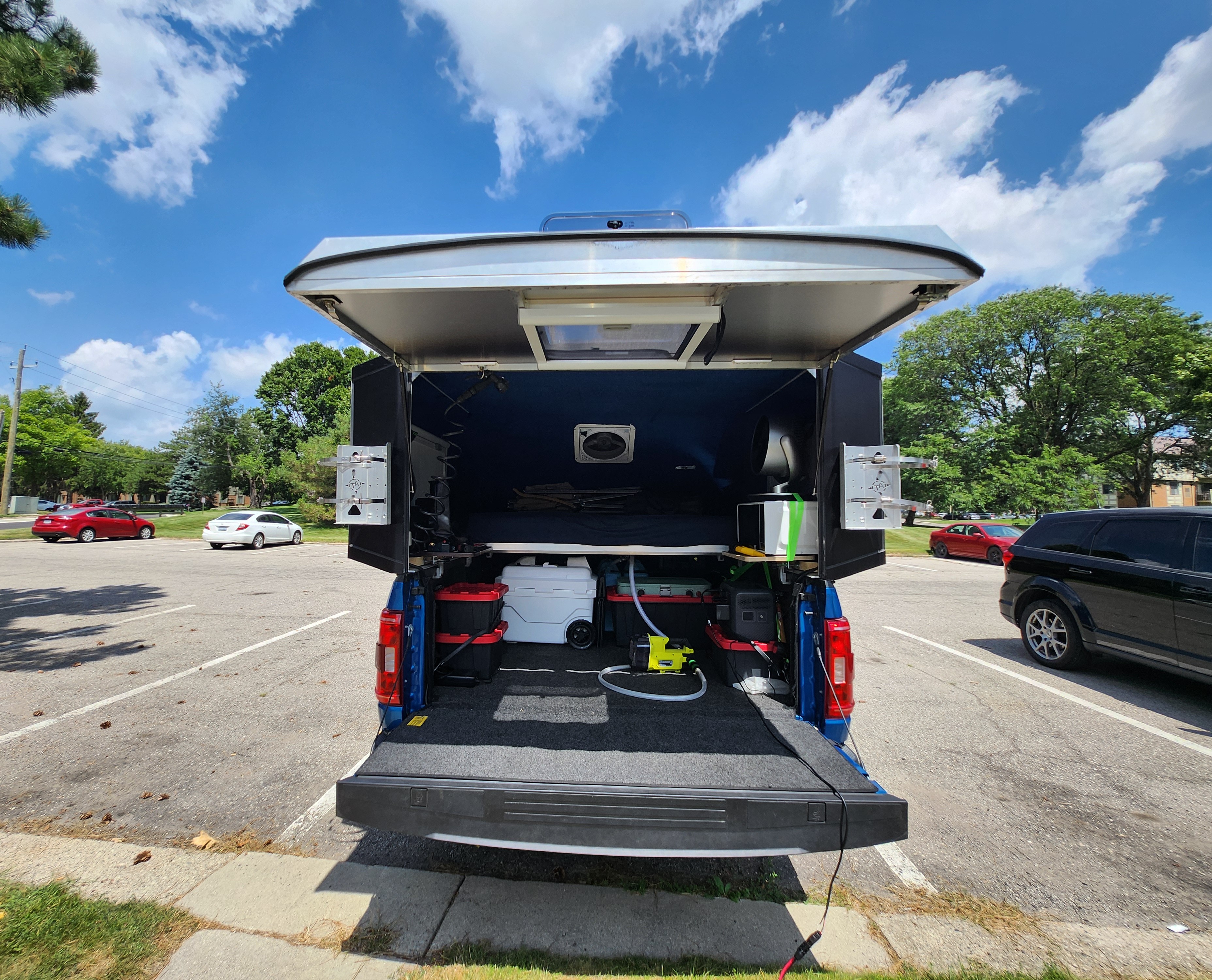

It’s very rudimentary because I’m essentially cramming everything into a 5 and a half foot long truck bed + back passenger seats to travel and live out of full time. Underneath my bedding area is where I store two Bluetti AC180s and one Bluetti EB70S, along with everything else. To power them I use 4 panels + a solar blanket which is IP68 rated. Two PV200s and Two PV350s. I run the PV200s in series and the two PV350s in parallel (since I am limited to VOC of 60). The AC70 piggyback charges the EB70S

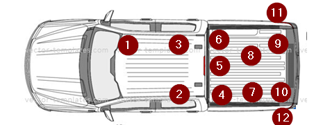

1= ALP Propane Generator on passenger floor. Storage bins for clothes on passenger seat
2= Iceco APL55 Dual Zone 12V Fridge. Sitting on top of fridge is Boxio Wash and Boxio Toilet crates.
3= My laundry solution, which includes a spin dryer, washboard, plunger washer, 5 gallon bucket, drain pan. Additionally my 4 Bluetti folding solar panels slide into this section as well, and locked down.
4=Bluetti AC180
5= Twenty gallons of onboard water storage (I have four 5 gallon Sceptre containers. Water is siphoned from my Ryobi water transfer pump which is the green device you see pictured above
6= Bluetti AC180, Bluetti EB70S which powers my 12V fridge, lights, and fan
7=IcyBreeze Ultimate which keeps me cool in hot, but drier climates
8= Coleman Cascade 222 and tote for kitchen appliances/dried goods
9= Bluetti AC70 and small tote for additional storage
10= Midea 22 Pint Dehumidifier + Bluetti Elite 30 V2
11= Microwave and Dreo CF714S air circulator
12= Olympian Wave 3 Propane heater and 3.8 gallon WaterPORT Daytank (pressurized water system)
