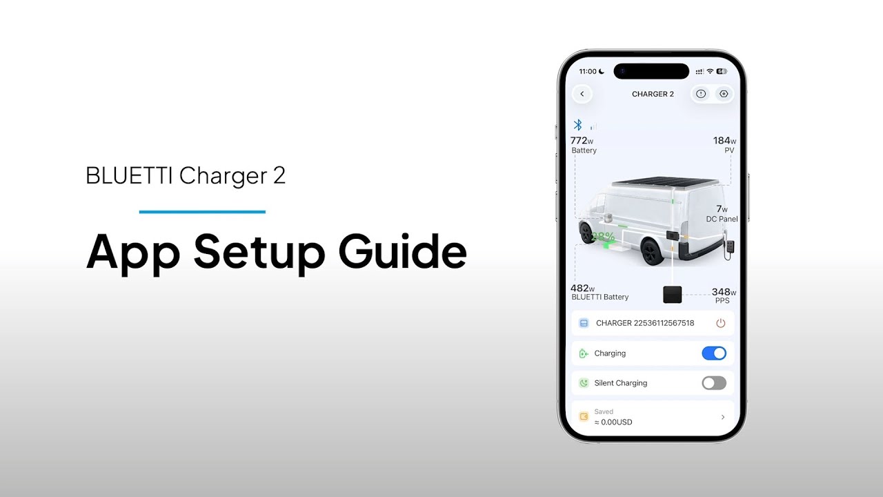

I’ve now learned that you can set the voltage in the Bluetti app for the CHG output and the battery has a built in BMS. The etaker f2000 worked so why wouldn’t the Charger 2? Not trying to be argumentative. I’m just not great with electrical.
