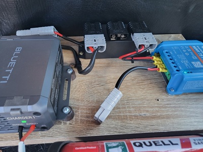

I had similar thoughts, however, I don’t power my Charger 1 (C1) from the start battery. As I am mainly using it to charge an AC70 & Elite 100 in Silent mode, the output power is not at maximum. The auxilliary battry is a 75Ah LFP with inbuilt 20A charger, which is charged from the start battery and through a 175A can solenoid, IGN switched.
I found the sweet spot for the 20A charger is setting C1 output to 35V. This draws 19-20A from the Aux Bat for a neutral load (charge = load) and gives around 275W charge. However, parasitic load was a concern along with my need to quickly de-install C1 for use in my caravan to top up either power station from a spare 100Ah LFP. Therefore I made it plug and play, but with a Caveat. Pics below
1 ALL DISCONNECT
Plug and play with Anderson totally disconnects both Chargers, C1 and a Victron 75/15 MPPT.

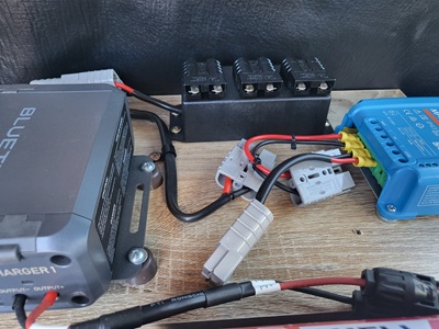

2 BOTH
Both the C1 and the Victron plugged in. (Caveat at the end of the post)

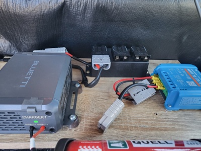

3 C1 ONLY
When driving I don’t use solar (Solar input is solar blankets)

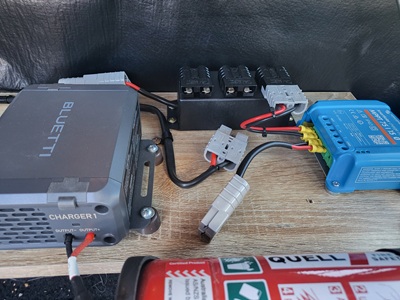

4 MPPT ONLY
When stopped (camped) I want solar not C1.
Caveat - When testing outputs, I found C1’s output was only 25W regardless of voltage setting. For some reason when both the MPPT & C1 were connected, there looks like an incompatability. Easy fix as using both at the same time is not likley. As an aside, I run an Engel 40lt Combi fridge freezer from the Aux Bat, which gives me a neagative 3A load when cycling and using C1, or around 1.5Ah, which is minimal and works for me.
