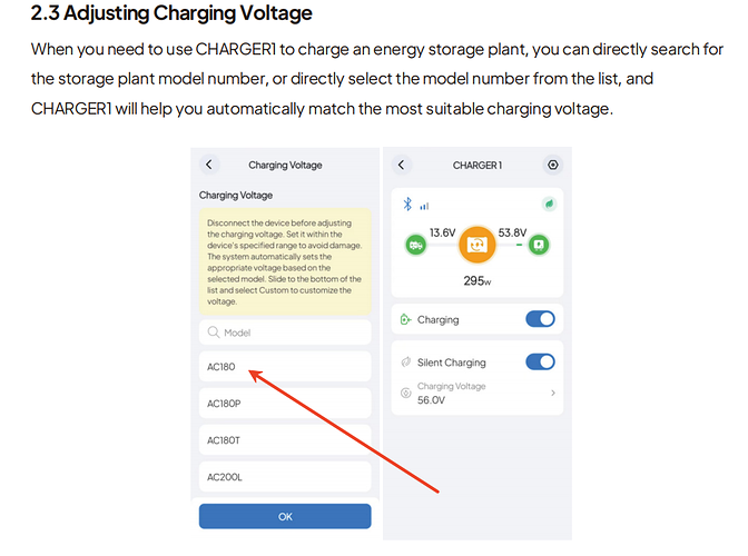

Hi @Duc, Based on the screenshot, we noticed that you have set the output to 27V.
Please adjust it to 50V or higher to improve the charging power.
My charger one installed this week is performing about the same as the one above with 27 V and transferring only 218 W. This is going to an AC180 that was paired automatically with the charger one. What should the voltage be for AC180? How do I correct this?
Hi @ejh, The AC180 accepts a DC input voltage range of 12- 60V, so we recommend adjusting the voltage accordingly.
You can select the AC180 model from Charger 1’s app settings to ensure proper pairing.
We have attached a screenshot for reference. Hope this helps.
