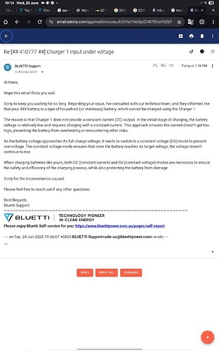

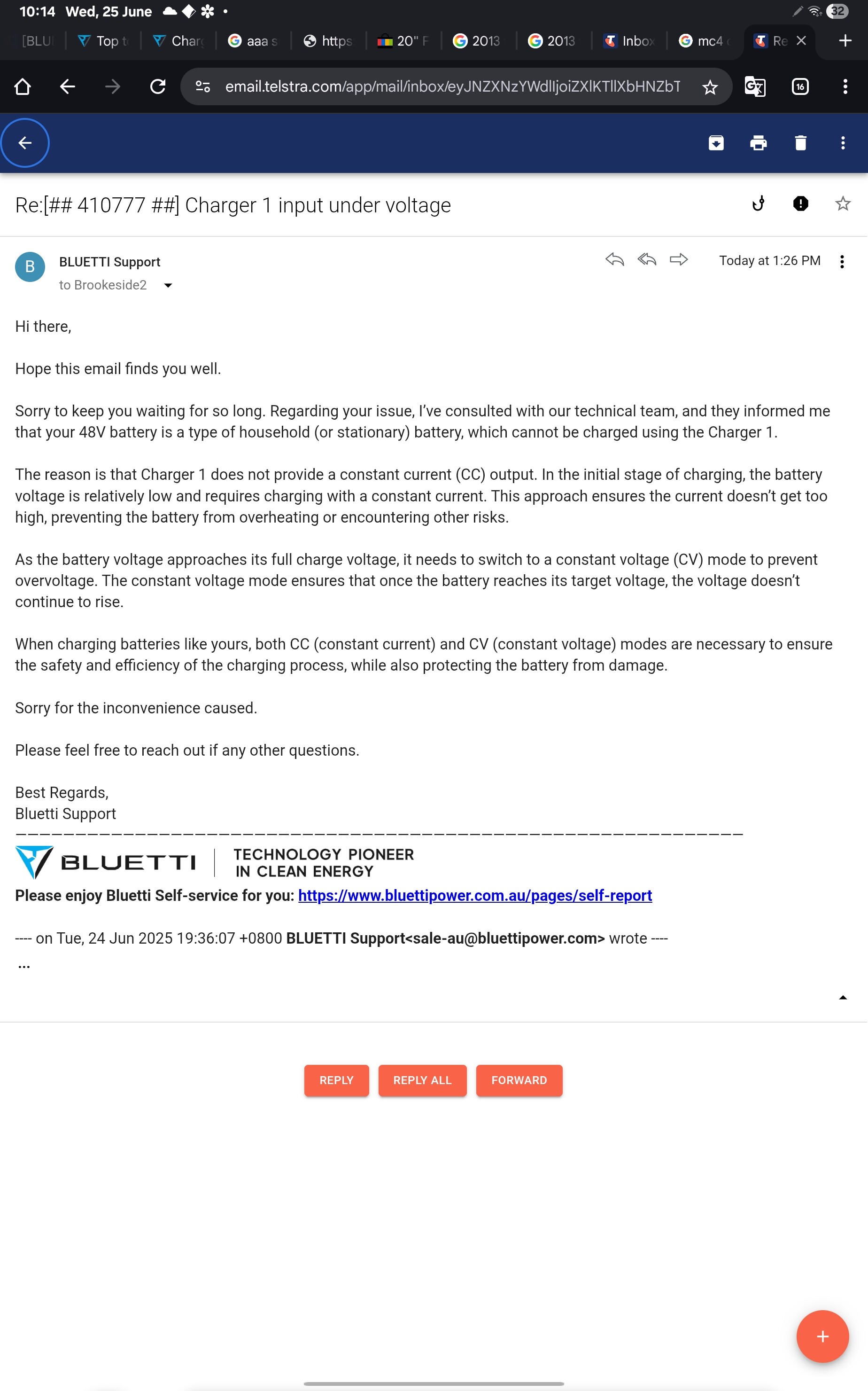

Thanks for the responses, see attached screen shot from Bluetti help. Looks like I may have a charger1 up for sale. Unless the smarter than me people come up with something!
What doesn’t make sense to me is my power station will accept volts and amps from a solar panel no problem with no (cc) or (cv) in sight?
