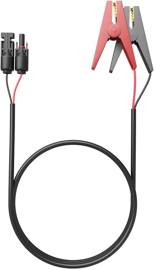

I’d prefer not to modify the existing wiring. Would adding a DC-DC charger such as the Bluetti D40 be the best way to do this, or can I simply use the Bluetti lead-acid battery charging cable directly from my coach batteries?
I think you will limited your input received to around 100 watts using a lead acid to 12/24 cable. But it can be done. The cable they sale is a MC4 to alligator clips , the mc4 ends will plug into the Solar charging cable to XT90 .
