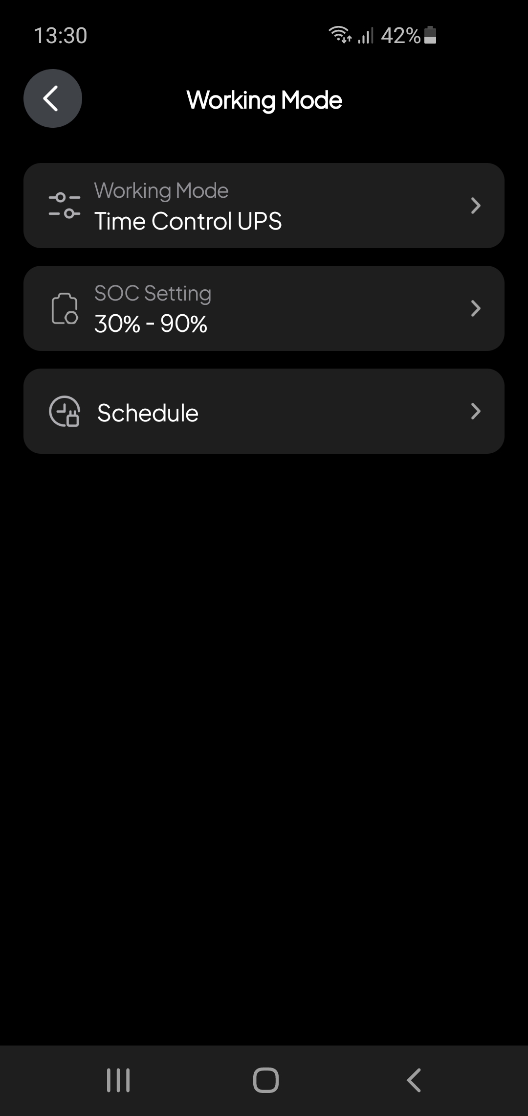

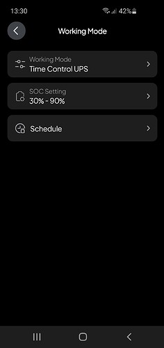

Updated and now my UPS settings are completely broken.

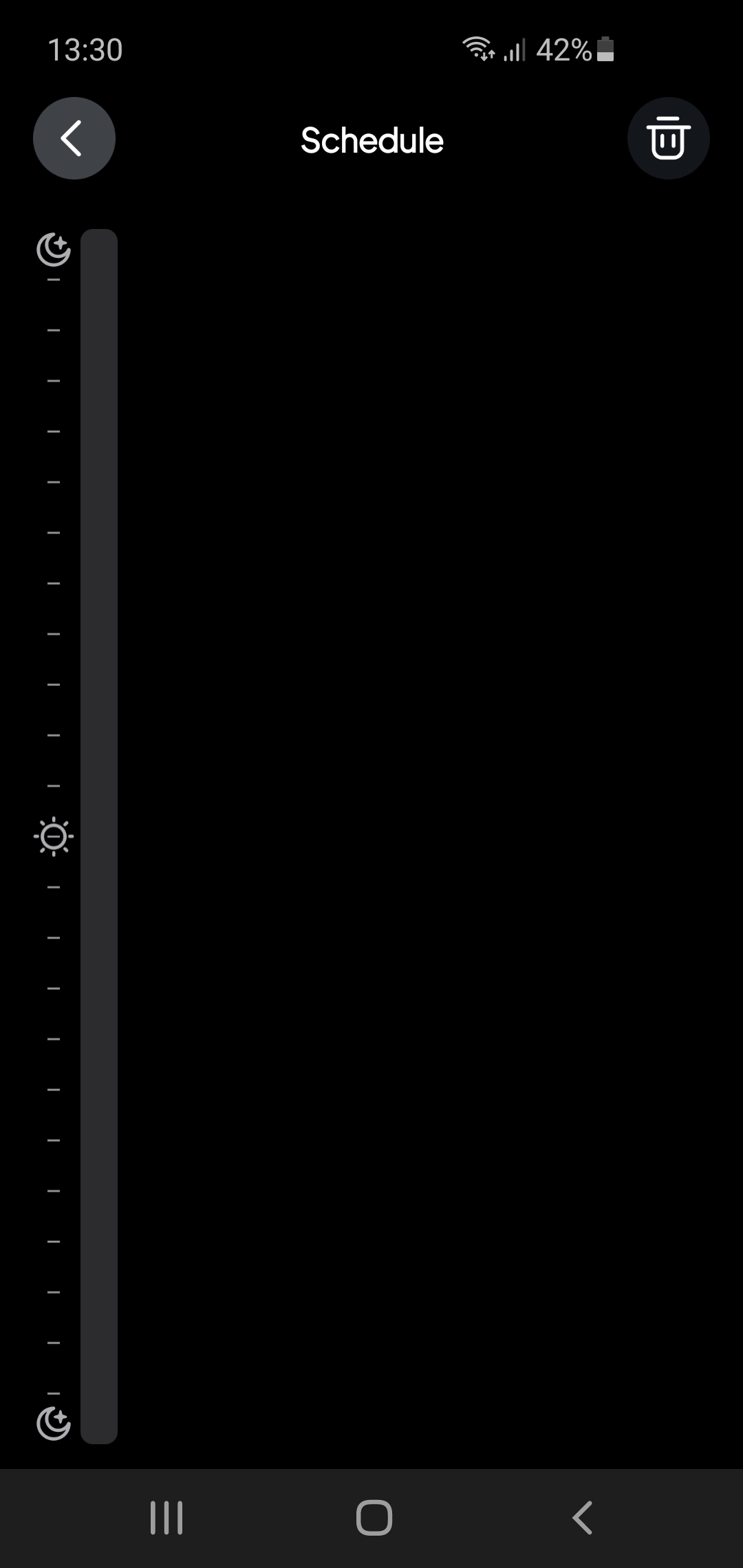

  1. Schedule cannot be set at all. Just empty screen without controls. Reset does nothing.

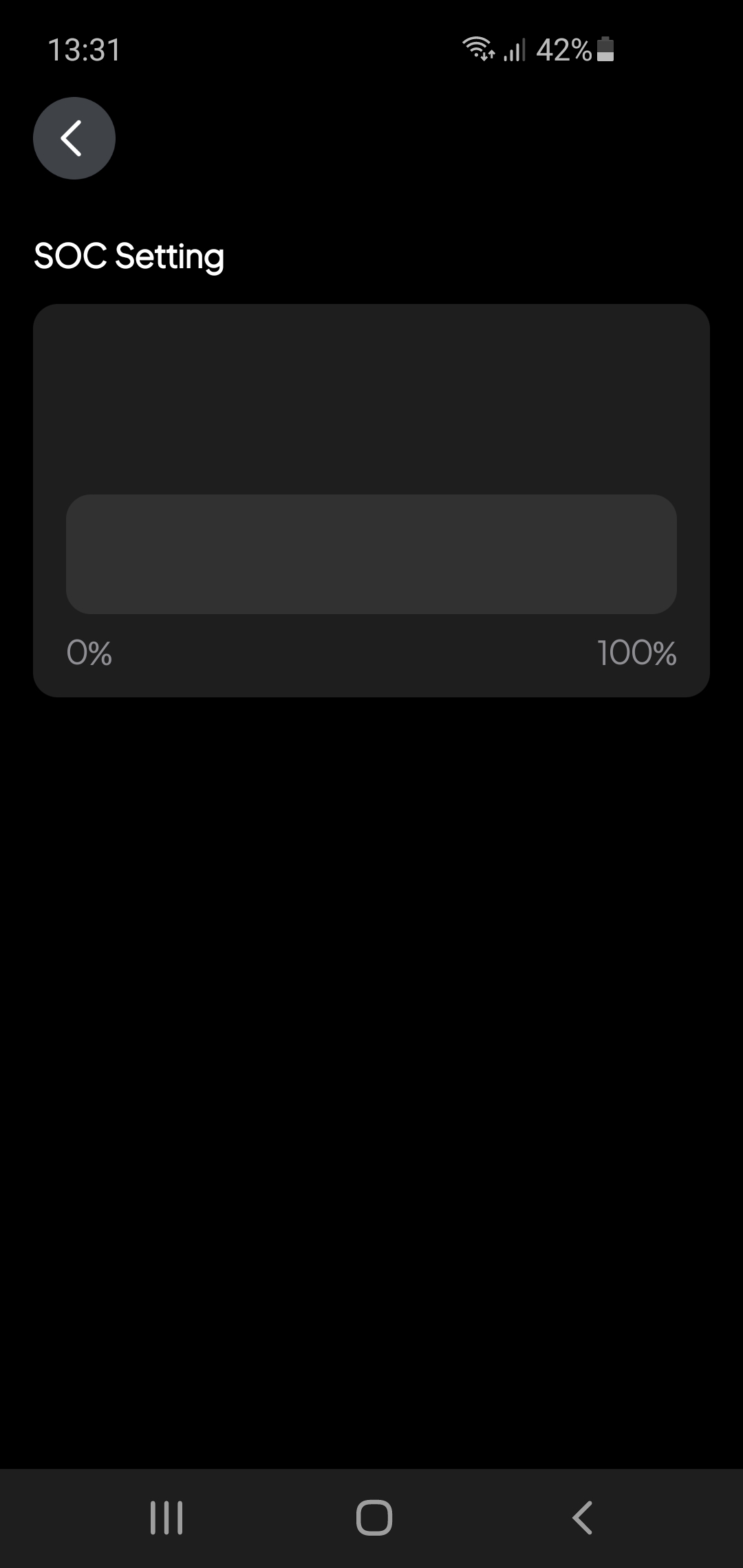

  2. SOC Setting is displayed in Working Mode submenu, but inside SOC Setting submenu it is not displayed.
  3. When in Working Mode submenu switching mode does not refresh view untill leaving whole submenu and going back.
I tries cleaning app data & cache, nothing has changed.
This is working in previous version 2.3.20 (I have installed it instead of .21 and issue 1 & 3 is resolved, issue 2 still present though, maybe it was always broken).
Please fix ASAP, this is critical and making station usage impossible now (without manual app downgrade, which most of user won’t know how to do).

Setting time schedule is not working in Time controlled UPS AND IN custom UPS.
Additionally: Changing the mode of operation does not refresh the settings page. You have to leave the setting and re-enter it to see changes. BUT: Time schedule is not working under any condition.
