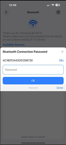

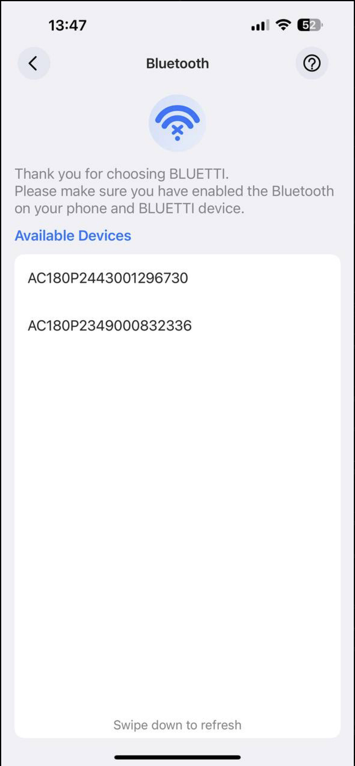

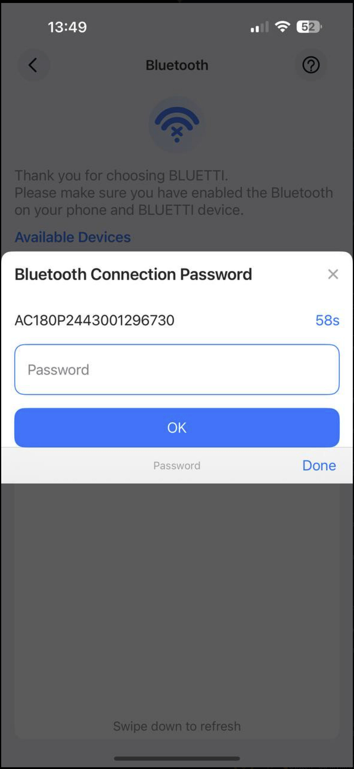

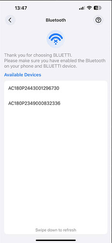

My friend has the same station.
His ID AC180P2443001296730
Why can he set a password, but I can’t?
In this screenshot I show that both stations are near me.
And here I show that his Bluetooth AC180P is asking for a password.
Hi @Alex3, This is dependent on the production batch.
As the Bluetooth password feature was developed subsequently, only devices manufactured in the new batches are equipped with this built-in function.
For AC180P units from older batches, this feature cannot be activated via software upgrades due to hardware constraints.
