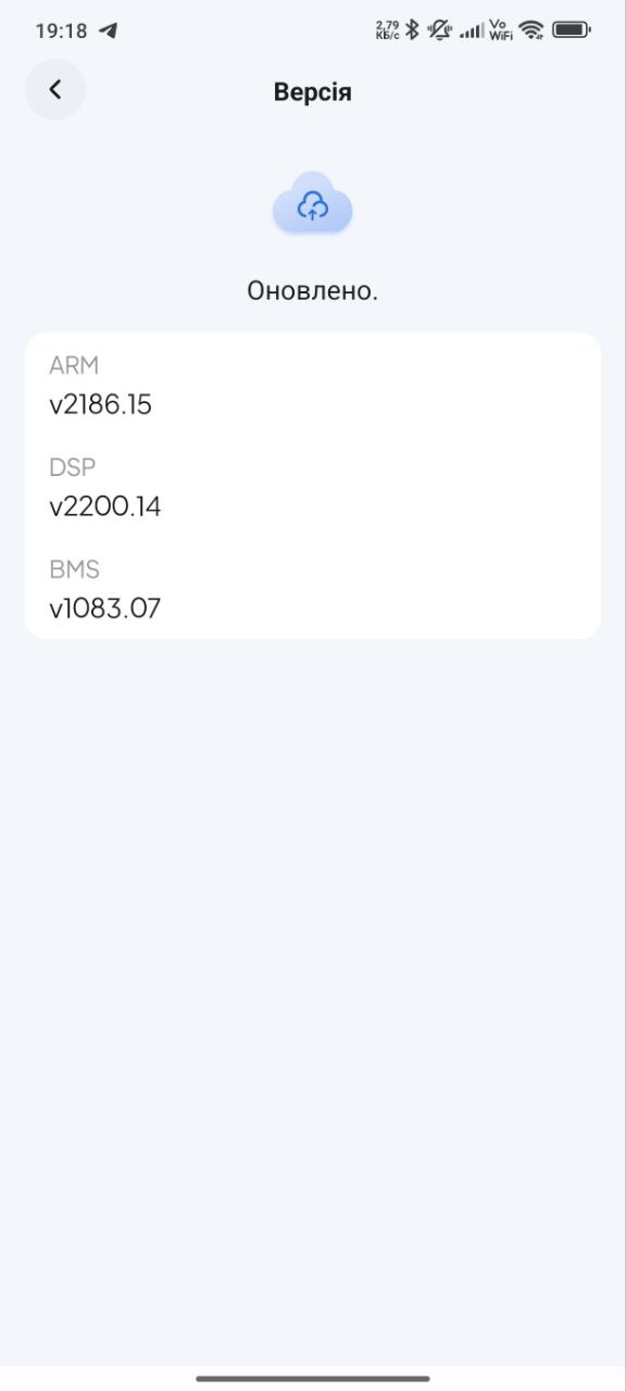

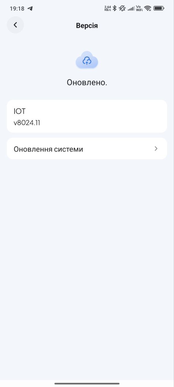

The firmware is fully up to date — I updated it immediately after purchase.

UPD. An update arrived today
IOT v8024.12
ARM v2186.16
DSP v2200.14
BMS v1083.08
and it seems the problem has been resolved. I’ll take a look in a couple of days and let you know if anything happens.

Hi @tadeslok, We consider this might be caused by the excessively high starting power of the refrigerator. We can confirm that our power station outputs pure sine waves.
We also have a new firmware version that has not been rolled out in batches yet. Could you please provide the SN code of your Elite 100 V2 so that we can push the firmware to you? We believe that upgrading the firmware will improve the performance of the device under high-power loads.
