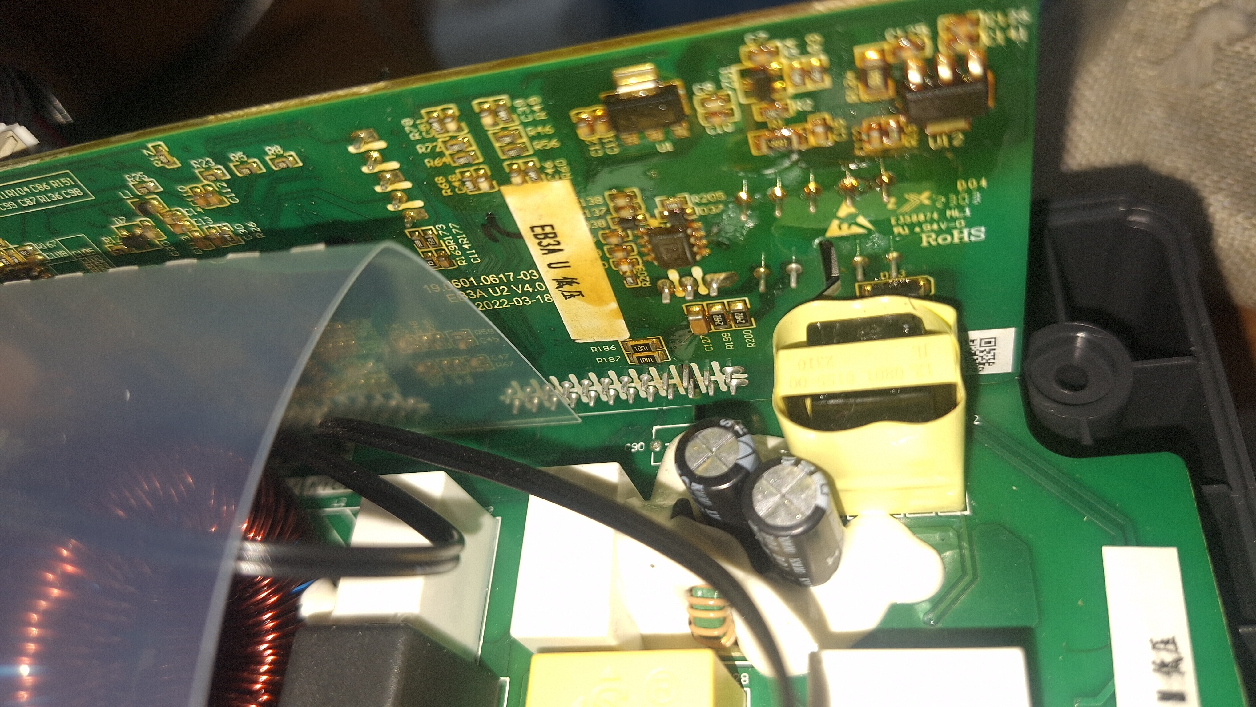

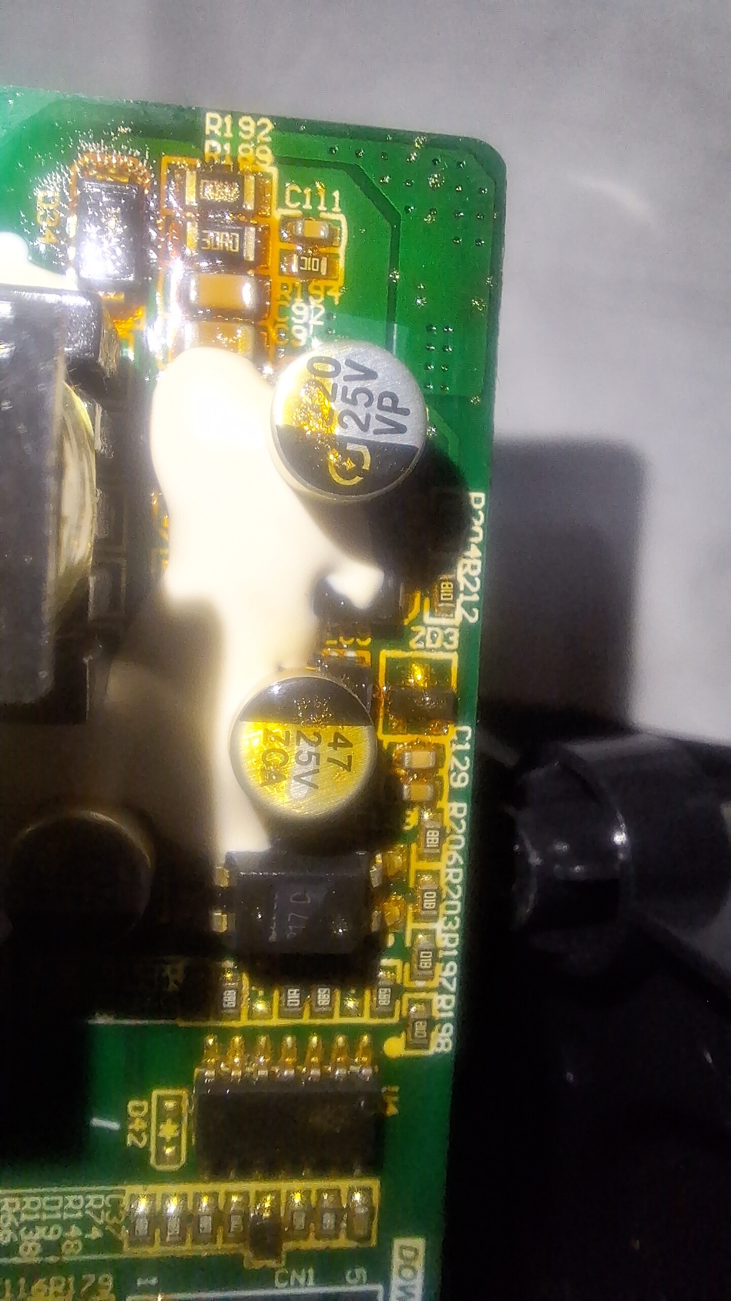

So this corner of the board seems burnt a little and really gets hot. Just tossing thisnin here for record.
These are both sides of the same part of the board.

yeah that exact section of the board i watched a few youtube videos it was getting super hot, some of them were even smoking, feels like a heatsink is required there, i own one of these units its makes me worry as well maybe @BLUETTI can explain what is happening there. its too hot that burning it off conformal coating
