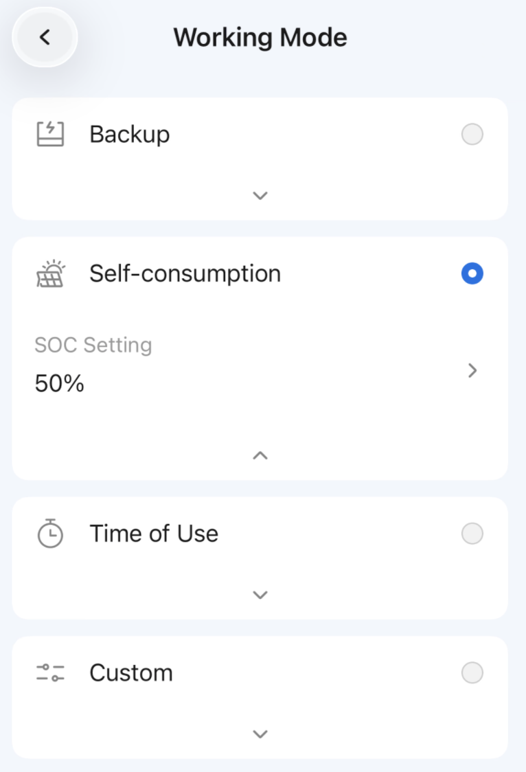

I think you want “Self Consumption” mode with a SOC threshold of 80%.

Hi, where can I find the “Self Consumption” setting in the app? I don’t see it…

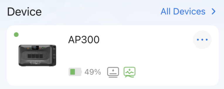

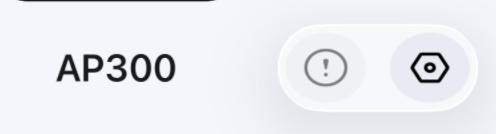

In my Bluetti app (iPhone, version 3.0.8, North-American split-phase 120/240V), I see this:
There you can choose Self-consumption and choose your desired SOC.
