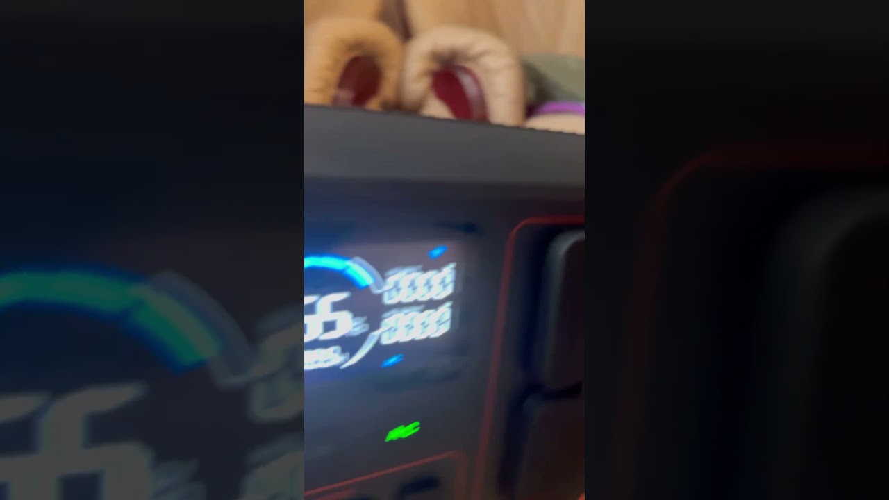

Hi @BLUETTI_CARE, i have bluetti AC200PL, when I turn on the AC button without a load, my bluetti makes a noise like a cricket or an electrical short circuit. If I turn on a load of up to 180-200 watts, this noise continues. If the load is more than 200 watts, the noise disappears.
Also, if you start charging the station, this noise disappears and it works very quietly.
I have encountered this problem with several other people, my question is, is this normal and happens at all stations, or is it a problem with a specific series of products?
Here is a link to how my station works.

Thank you @BLUETTI_CARE for your reply, but unfortunately I can hear this noise throughout the entire room, even with the TV on. It’s not just me who hears it, but other members of my family as well, It is very uncomfortable to hear high frequency noise. It’s likely that my Bluetti unit is noisier than others.
At least a few other users are having the same problem… For the rest, it’s complete silence…
Perhaps you could solve this problem by updating it so that, for example, the inverter doesn’t switch to economy mode or something like that?
