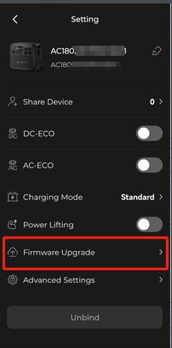

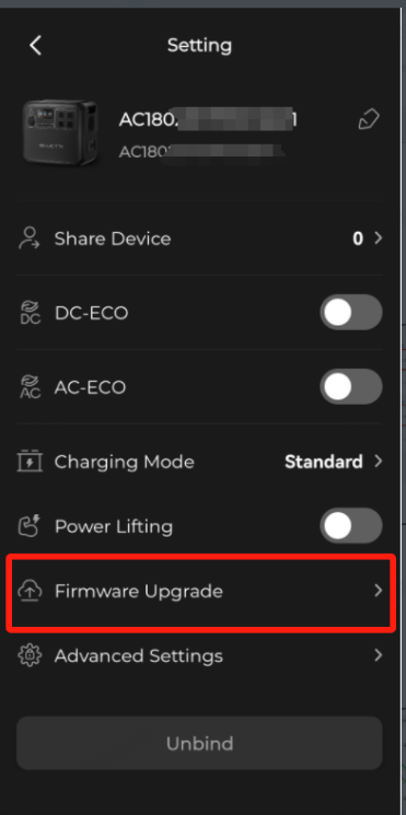

Hello,
  1. Please check in the app if all firmware is up to date.
