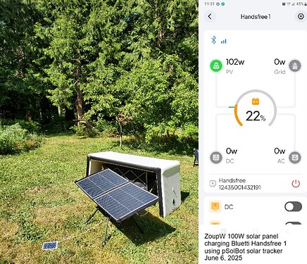

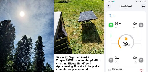

It would really help to know the make/model of the power station you want to solar charge. Knowing the solar input specs of the power station will help determine which panel is best. That said, there are many better and cheaper panels than either of the Bluetti panels you cite. The most efficient panels that produce the most watts are the N-type 16BB (TOPCon). My favorite is the ZoupW 100W. It consistently gets near, at or above the rated output. Here I installed it on a pSolBot solar tracker to charge a Bluetti Handsfree 1.
