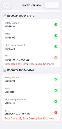

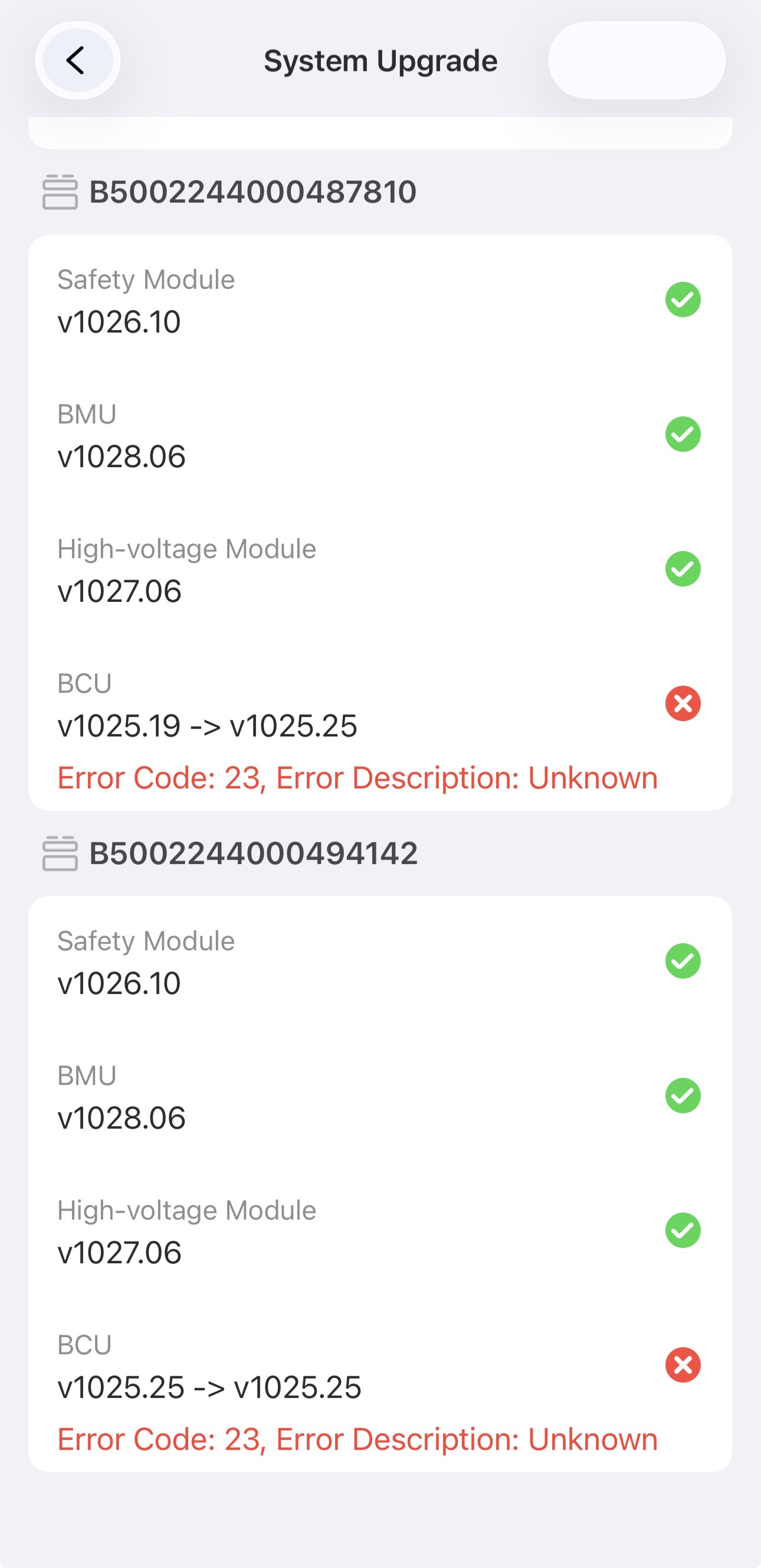

So my system of EP760 and two B500 batteries wouldn’t charge from grid. I’ve been told that I need to make sure my system is 100% up to date with the software updates, and that the latest versions are installed. I was able to install almost all updates using the Bluetti App, except for the BCU part (v1025.10 → v1025.25 doesn’t install over Bluetooth). The progress gets to 33% and fails, returns an error (Error Code 23, Error Description: Unknown).
How do I finish the update installation? Is there any other way to do it other than Bluetooth perhaps?

Thanks mate! So from my experience here’s what I had to do to install the updates. I’ve shut down the whole system, disconnected the communication cable from one B500 unit, launched the system with one remaining B500 and that’s when the updates have installed just fine. Then I’ve shut down the whole system again, switched the connections to hook up the other B500 (the one that wasn’t updated yet), and repeated the process with it. Then shut it all down again and connected both B500 units.
