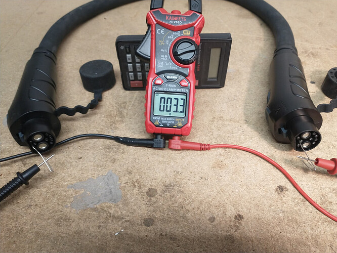

Try a different cable if you have one. I had a cable fail a few years ago and it caused blinking lights on a battery.
In my case the resistance on one of the communication wires in the cable was too high at 3.3, all of them should be near zero.
Thank you for the advice and picture. I have two B300s, so I exchanged cables, and got the same results. Both cables appear to work fine.
