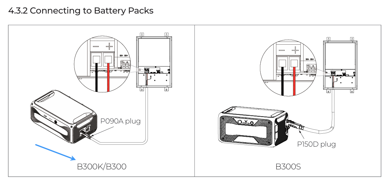

The B300K itself does not support DC charging, but it can be charged via solar power using the SolarX 4K. We have attached a screenshot of the SolarX 4K instruction manual for your reference.

can I effectively use the SolarX 4K with my AC500 + 4xB300, 1xB300S, and 1xB300K system to feed in additional solar power?
Does the SolarX 4K charge the batteries in addition to the power of the AC500’s two inverters?
Is the additional charge distributed evenly across all 6 batteries? Where do I need to connect the SolarX 4K for this? Simply to one of the 6 batteries?
Thank you!
Joachim

Hi Joachim, We believe connecting it to either the AC500 or a battery pack works, and there is no difference between the two options.
Since the AC500 requires connection to 6 battery packs, there will presumably be no extra ports available to connect the SolarX 4K. Therefore, we recommend connecting it to a battery pack instead.
Yes, the built-in BMS (Battery Management System) will balance the configured charging current to ensure each battery charges evenly.
Additionally, we advise users to make sure the charge level of each battery is consistent before paralleling them. This charge balance can be maintained manually.
