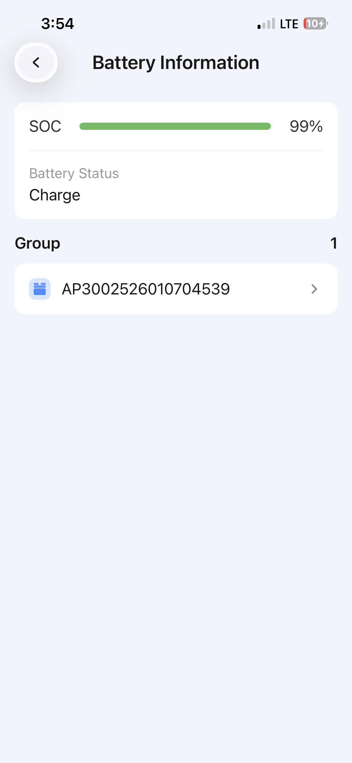

If the main power station supports app operation, please connect them, power it on, and then tap the SOC icon in the center of the app. This will allow you to view detailed information about the B300K.
conectado a un AC200MAX, no aparece nada en Grid, estando conectado
Hi @Durval, Please correctly connect the B300K to the AC200MAX, and then lock both ends of the connection cable.
Then please make sure that the B300K is powered on. In this way, can you see the battery status of the B300K by clicking the SOC in the middle of the app?

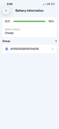

Is SOC in this image the B300K? I’m working for hours now & this thing is still blinking twice then pauses.
