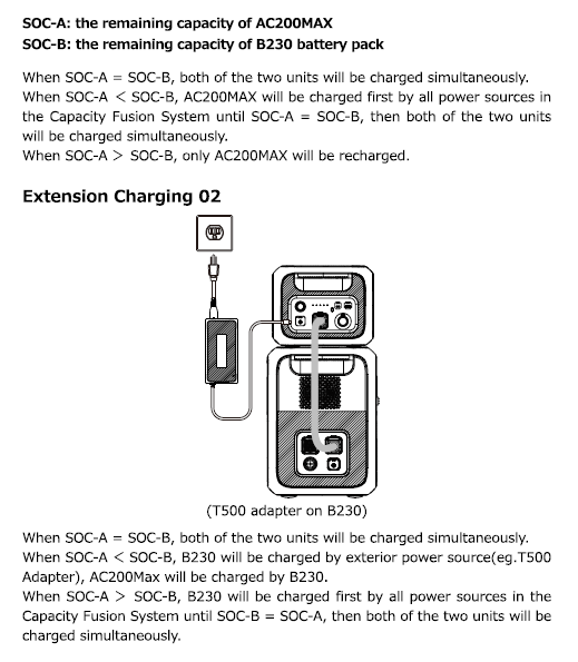

I think you should try charging the B230 alone until it reaches or exceeds the SOC on the AC200Max. I have both (actually I have four B230s). And when you do an update on the app, the B230(s) should be connected to the AC200Max.
I would try that while you are waiting to hear from Bluetti. Did you email them?
