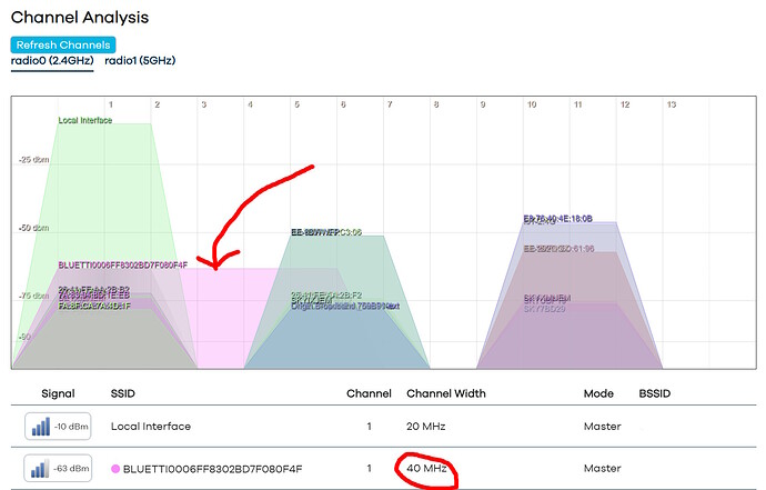

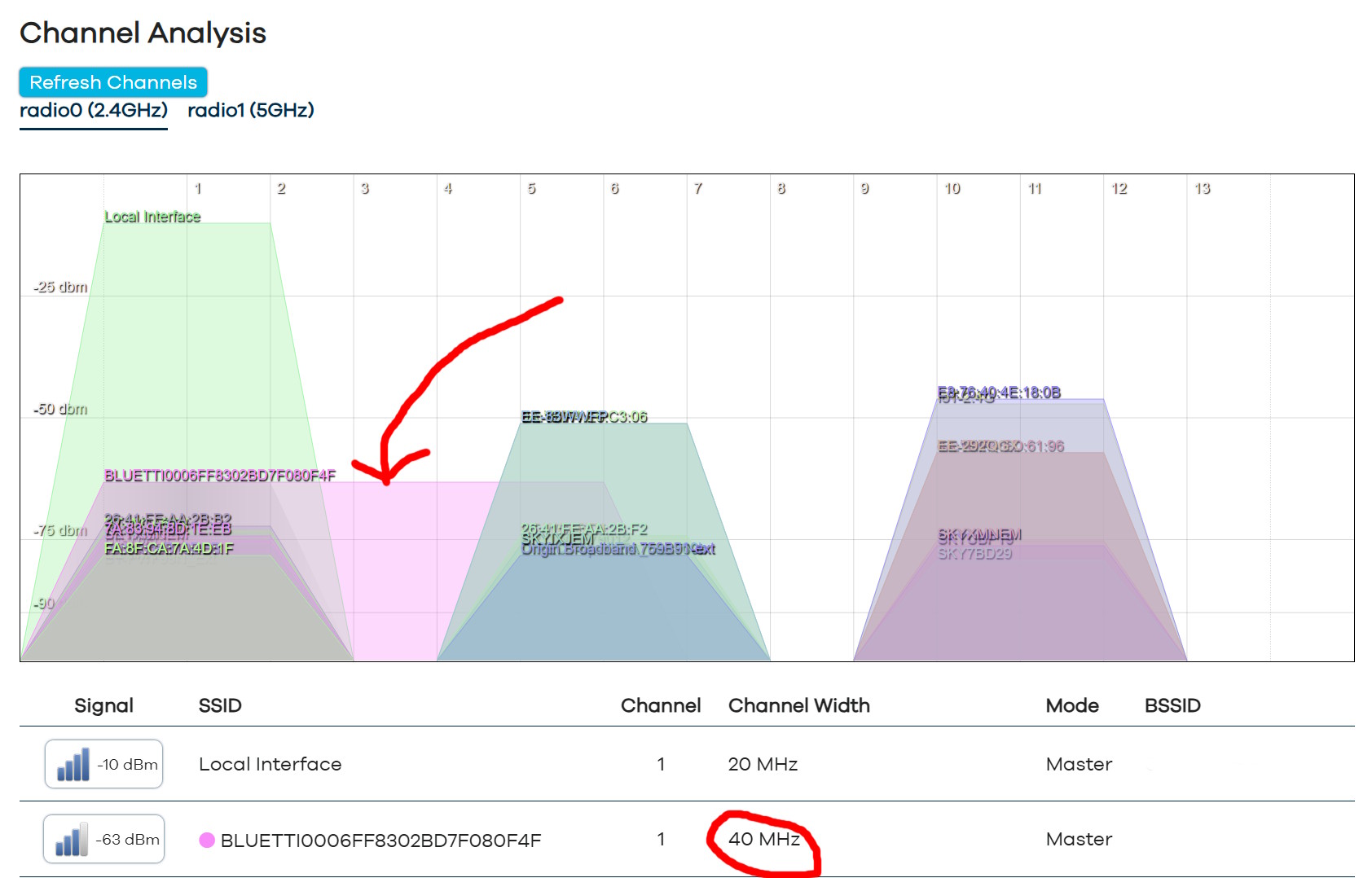

After latest Update the Apex300 creates a wireless mesh AP. I can’t find a way to disable it. Please tell me how to disable this AP. It is 40MHz and overlapping my main networks so I don’t want this ‘feature’. I find this a strange decision to add such a feature without an off switch it is highly intrusive and has security implications.

I’m also seeing this un-wanted 40MHz wide Wifi network being created on 2.4Ghz channel 1 without my consent.
