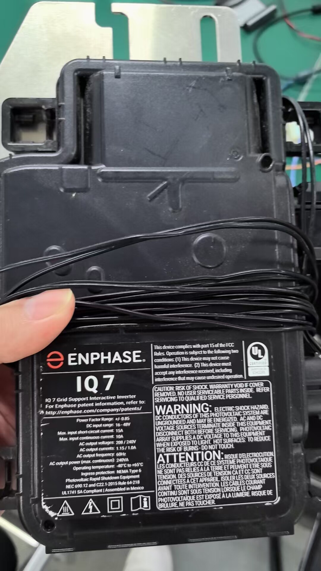

Here’s the Enphase inverter for your reference.

The Enphase IQ7 is a micro inverter. Does the AT1 system work with grid tie string inverters too? I am using a Solar Edge SE10000H-US grid tie inverter, so would want to see how I can gain confidence that it would work with Apex300 AT1 before investing in greatly expanding the setup.
