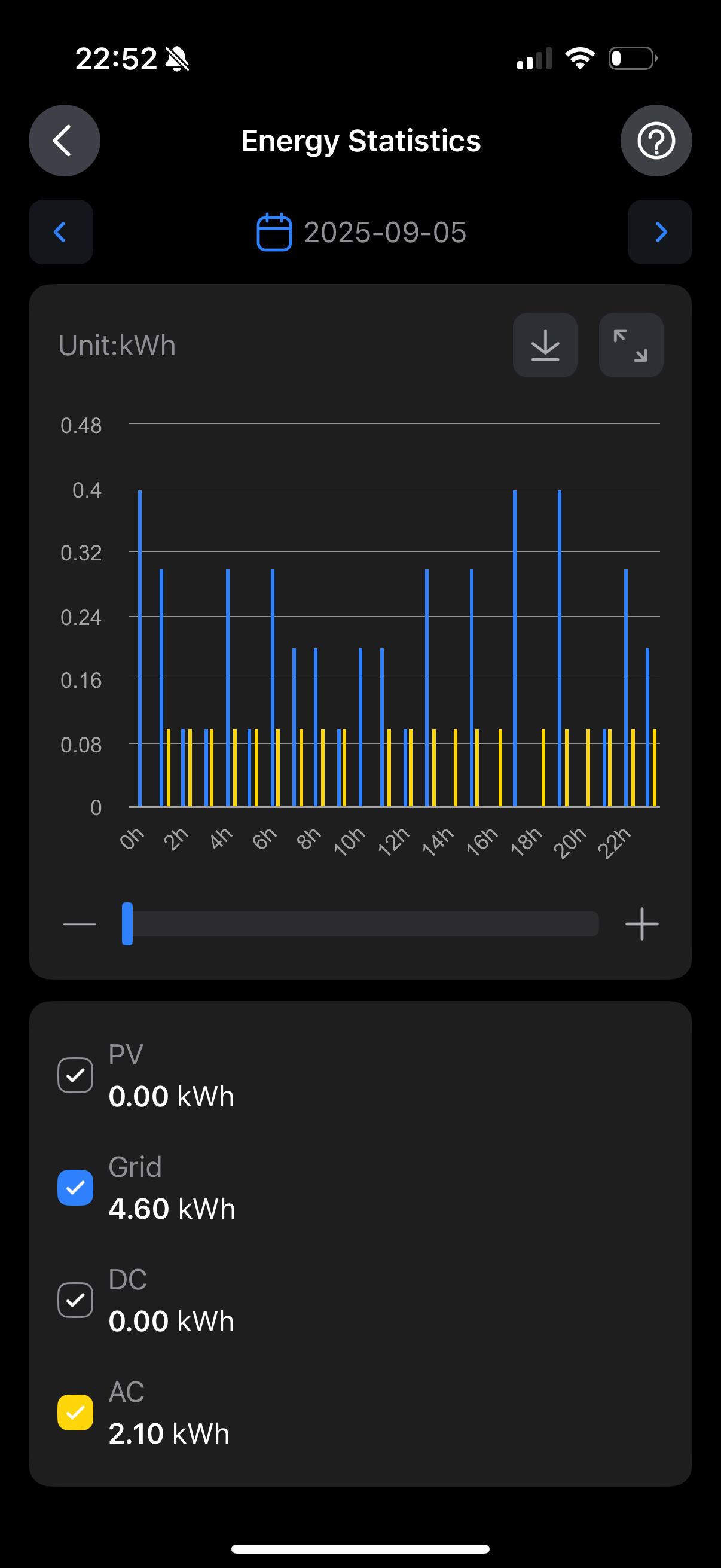

I have an apex300, 1xB300k and 2xB300. Charged using grid and providing 85w or so of power for networking equipment. SOC is kept at 80% using self consumption mode. When I look at energy use, I noticed the Apex300 consumes 4.6kwh from the grid each day to supply 2.1kwh of energy. The grid consumption is accurate based on my emporia monitor. Where did the extra energy go? Is it this inefficient? Are my settings wrong or is there something wrong with my unit?

I understand a 3.8kw inverter would take some power, but this seems like a lot. The extra 2.5kwh /day would imply over 100w of wastage. That is about 3% of inverter max power, which isn’t good. Apex300 was advertised to have low idle draw, this isn’t low at all.

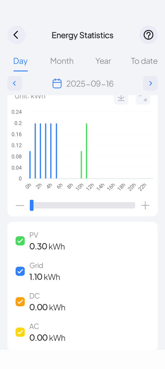

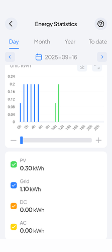

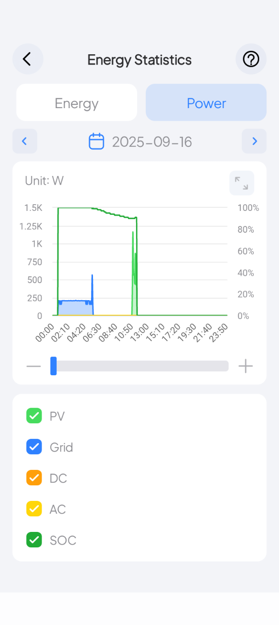

Hi, I’m in the UK
Midnight on the 16-09-25
2 Apex 300 + 2 x B300K fully charged, and connected to
HUB A1
Direct grid connection (12:00 am - 5:30 am)
Each APEX 300 + 1 connected battery in stand-by mode used 100W each hour
I think I made a mistake buying 3 x APEX 300 + HUB A1 + SolarX 4K
Selling them on eBay looks like the only way to cut my losses.

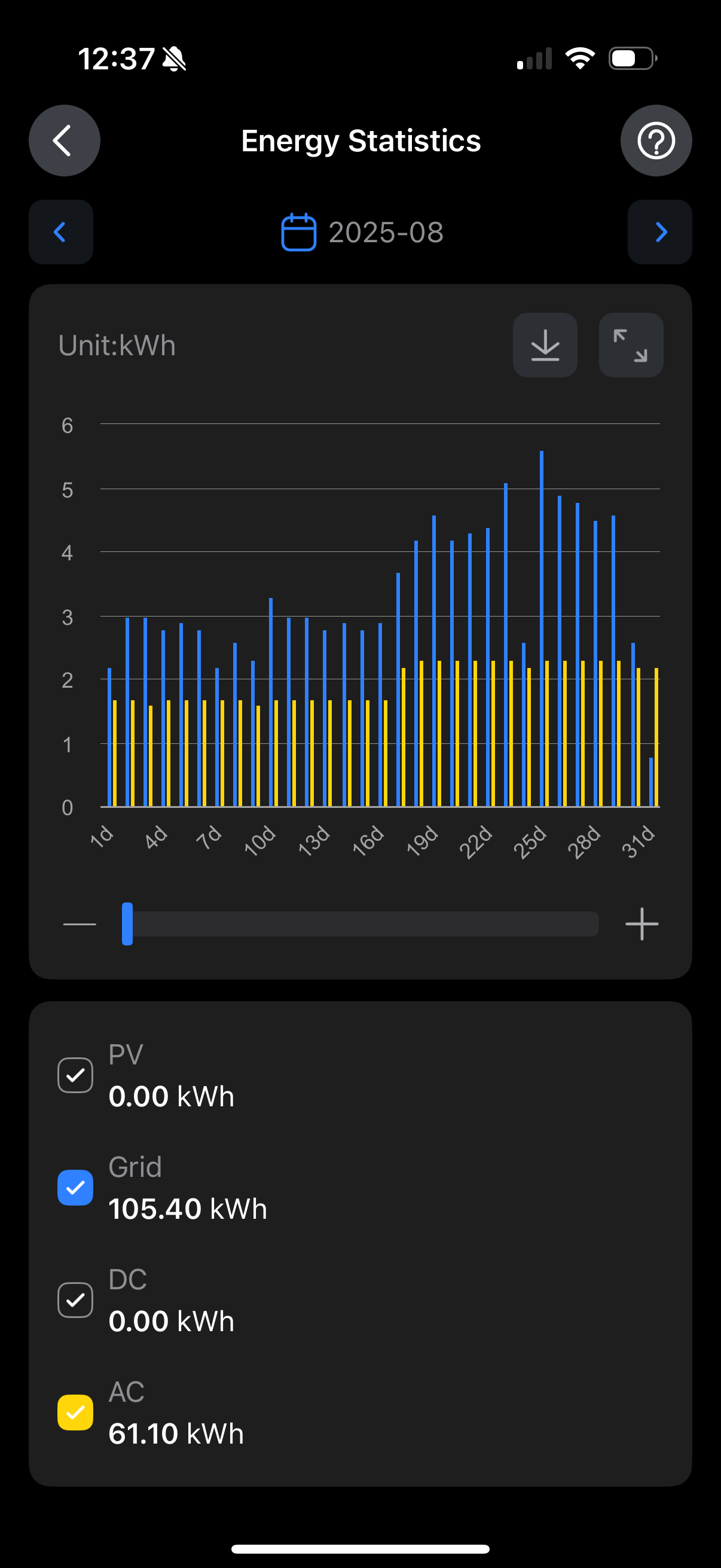

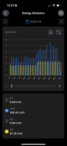

Looking back through my energy use history on the app (thank you Bluetti for providing that), I can see that my grid usage jumped quite a bit when I switched from 120V inverter mode to 240V inverter mode. Back when I was on 120V AC mode, the Grid pulled 2.4kWh a day and supplied 1.7kWh of AC. When I switched to 240AC output, the grid input jumped to 4.2kWh and AC output increased to 2.1kWh without any changes in the load. Perhaps this is much more efficient in 120V mode where it can do grid pass-through, but in 240V mode than both phase inverters need to be on since my input is only 120V, something has to make the 240V from the battery. Will do more testing and advise.

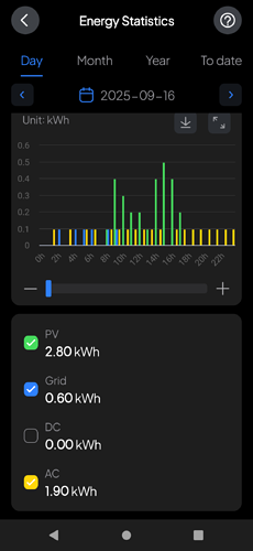

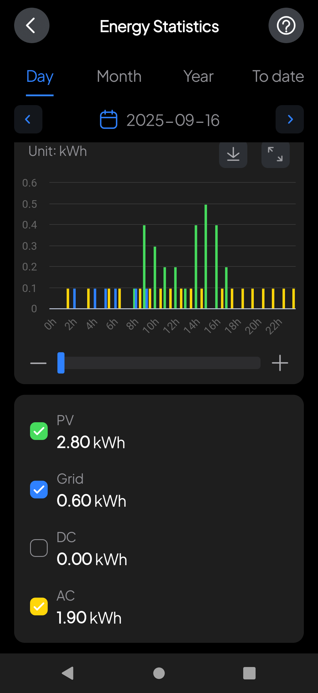

snowstorm you grid draw does seem excessively high. I am running a full size fridge/freezer in a garage. The normal draw is about 85 watts unless in a defrost mode where it jumps to about 165 watts. Depending on the ambient temperature it might run as much as 18 hours in a day since it is in a hot environment. Anyway your grid draw is way more than mine and I am operating in 240V mode. I believe the app is showing me correctly. Yesterday I made 2.8kWh from solar, and my fridge drew 1.9kWh and I drew .6kWh from the grid. So if we take the 2.8kWh and add in the Grid .6kWh we get a total of 3.4 and the fridge used 1.9 so I lost 1.5kWh running the inverters and the electronics. this is a bit higher than what the tubers have calculated as daily parasitic load. And as others in this string have said the calculated efficency is not great for low powered loads and it will only go up on paper if you increase the load as the ‘daily power tax’ for the unit remains the same no matter if it is producing zero or higher loads. your basically losing 2.5kWh a day which seems high.
I went thru a weeks worth of data, and my unit is consistently wasting 1.5kWh every day. The solar produced and the AC load vary every day as one would expect, but it is always adding up to 1.5k wasted. I am going switch my unit to 120 volt mode, I will let u know if a see an improvement in a few days. I went back and watched Hobotech he tested it at only .6kWh for a 24 hour parasitic load test and reported that the unit would last at 4.75 days inverter on with no loads. Jasonoid and Johnny’s Weekend reported very similar numbers. I think someone from Bluetti needs to explain this better to us or pushout a firmware rev. Something for sure is not matching our useage to what the YT reviewers reported for usage.
You can see exactly where I went from 120v output to 240v. The overhead loss totally jumped. It is interesting that the measured AC out also increases a bit even though the load was exactly the same.
In early August I was running time of use so pass through was inactive e between 4-11pm. In mid August I switched to 240v and it never pass through, all AC out is driven from the inverter.
