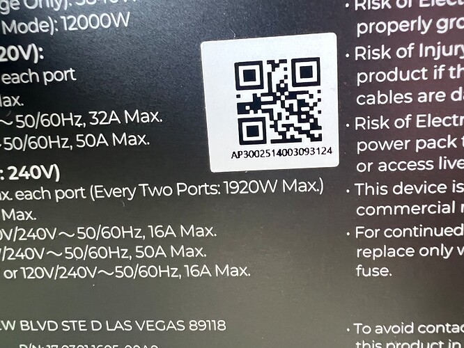

SN: AP3002514003093124
Photo showing SN. I tried to include a “live image” of the light flashing but the system said that as a new user I could only include one item. Please let me know if additional photos are requested and if so, what specifically.
