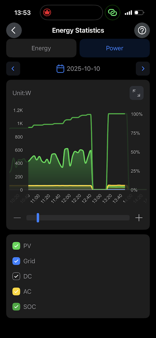

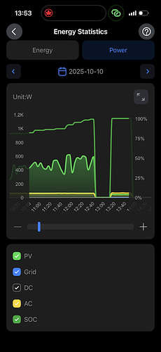

I am experiencing an issue with my Apex 300 where the AC output would unexpectedly shut off.
This happened 2x to me. And each time, the device is plugged into the grid, performing grid pass-through power on about 70w of AC load, while also charging with solar (400-600w). It would charge normally, and the SOC would increase much faster than expected, hit 100% and then the AC output would shut off. I can go and press the AC output back on manually and it appear to work OK. A few days later, it happened again, charging using solar while plugged into the grid, SOC increase normally then rapidly increase, hit 100% SOC and then AC powers off. Has anyone seen this?

The issue here isn’t that the Apex300 turned off, it stays on, but the AC output turned off unexpectedly. Eco mode is off. The Apex300 is powering AC load of about 70w both times this happened. Grid is plugged in and solar is charging it at around 500w with bright sunshine, SOC is increasing and rapidly increases to 100% and then the AC output shut off (the machine is still on). You can see what happened in the graph above. There is no error code in the history. This happened 2x under the same circumstances.
