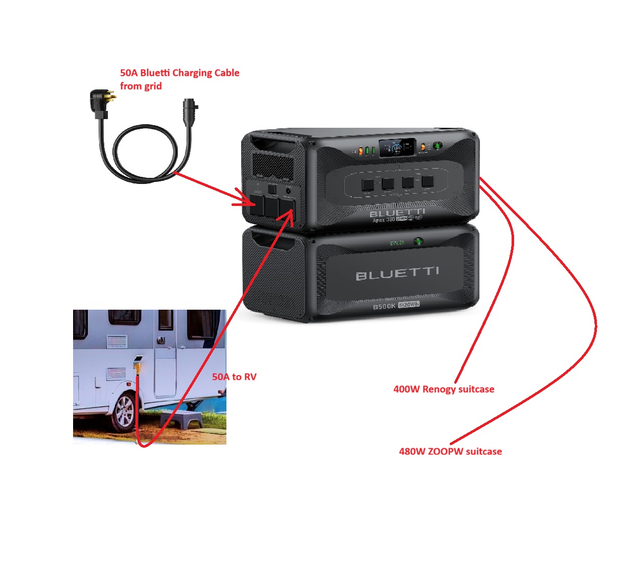

I’ve attached a picture showing how I plan to connect everything (shore power to Apex, Apex to RV, plus two portable solar suitcases).

  1. With the Apex connected as shown in the picture — and assuming the Apex/B500K batteries are sufficiently charged — will the Apex supply power to the RV from the batteries and solar instead of using grid power, even though it is still plugged into the grid?
    At our seasonal campground we pay for electricity, so I’d like to run on solar and batteries as much as possible to reduce the electric bill. I know I can physically unplug the Apex from shore power, but if possible, I’d prefer not to constantly plug and unplug cables.
  2. In the same setup, if it’s a cloudy day and the batteries are getting low (not charging from solar), will the Apex automatically switch to grid power to run the RV loads and recharge the Apex/B500K at the same time?
  3. Does the Apex 300 support any form of load-sharing or “power assist” functionality similar to a Victron MultiPlus II? Specifically, can the Apex supplement a limited AC input source (e.g., 15A or 30A shore power) with battery output when load demand exceeds the programmed AC input limit?
  4. For the above scenarios, what operating mode and settings are recommended?

First off, you will not get 50 amps with one Apex. Yu get 32 amps in 120v and 16 amps in 240v.
  1. yes
  2. yes
    You can use SOC and set the Apex to charge from the grid .You can go as low as 5
    % before it starts charging from grid.
