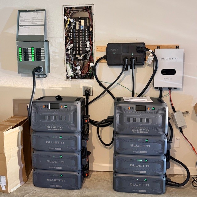

For my setup I have 2 - Apex 300s with 6 B300Ks 3 on each stack with the Hub A1 and two SolarX 4Ks in parallel.
For my sub panel I am using a Nature’s Generator 12 Circuit 50 amp Manual Transfer Switch
I had my electrician connect the essential circuits so basically everything in the home except the AC/Heater/Emergency Heater/Water Heater/Oven/Washer and Dryer
The Manual Transfer switch is connected via the 50 amp outlet on the Hub A1
Then I had the electrician install a 50 amp outlet on the main line under the main breaker panel that the Hub A1 plugs into. That allows the battery to recharge if you want it to.
Currently I have mine set to custom and use a self consumption so it charges only on solar and drains to the set charge level and then select the Charging option to tell it to charge off of main when I want it charge using both.
I will be swapping some circuits to connect the AC/Heater once all my panels are mounted as they are heat pumps and pull well under the max of my units.
