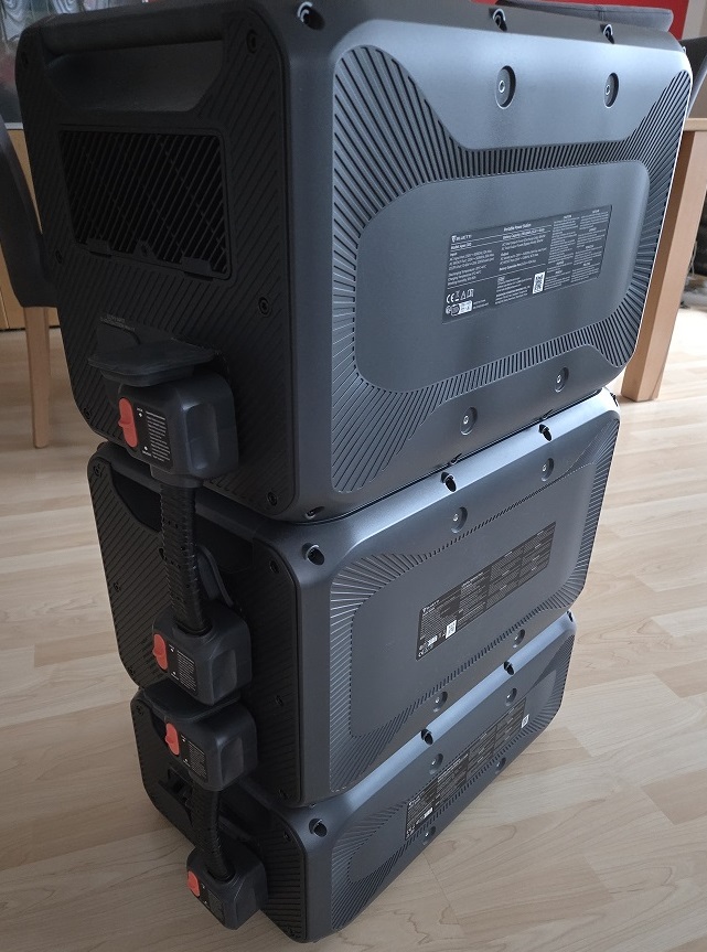

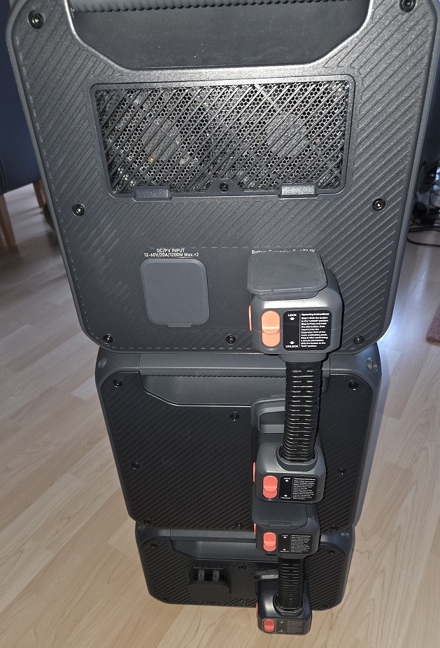

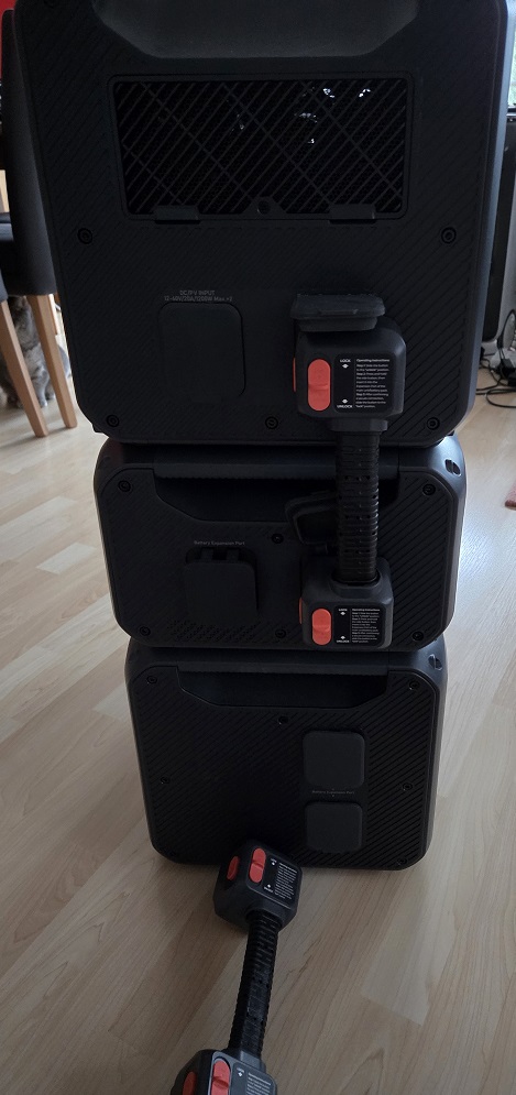

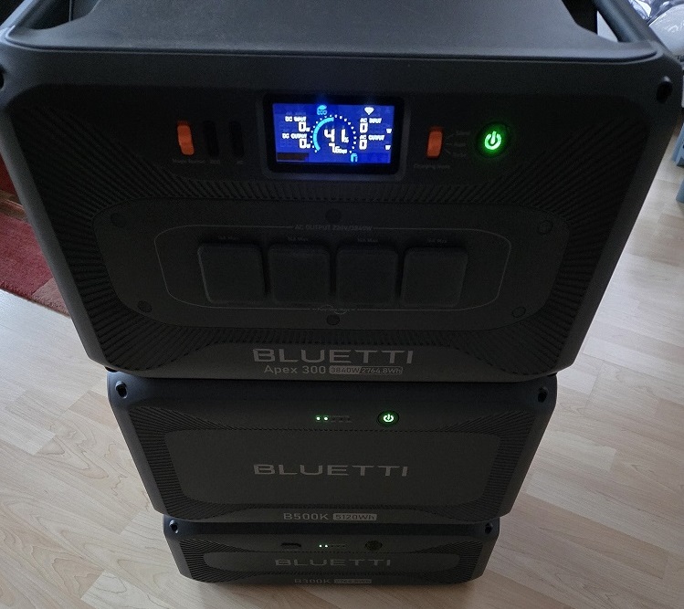

of course you can! I combined the Apex300 with a B300K and the B500K. One thing you really need to have a look on is the order of connection. The B500K needs to be the first expansion to connect and the B300K at the botton. Otherwise the connection dont work.
But works perfectly as it is!

That’s a lot of watt hours you have there, what are you going to power? It all looks very neat with the new flat cables.
Yeah, the flat cables require a certain order but it looks really clean. Since i want to mainly use Solar power to power my devices, its not much in use right now. Priority charge is the EP2000. In spring i want to use it to power my 3D Printers. They need a lot of power over a long time and this setup with many watt hours + lot of AC Plugs is perfect for it ;)
Many thanks for the photos, could you please tell how far CA90 sticks out from the body of APEX and B500K in cm?
Hi @aqv33
Its about 5,5 cm. Muss less then the old cable before :)
Many thanks, could you please make a photo on the side of the station so it will be visible how far it sticks out from the apex body?

Not much to show. Like i said, the plug shows 5.5 cm from the side of apex300. You need atleast that amount of space to the side
