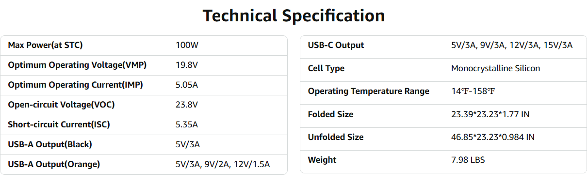

I recently discovered a very lightweight 100W portable panel that is N-type 16BB and regularly outputs at, near or over rated watts. The ZoupW. Very reasonably priced.
