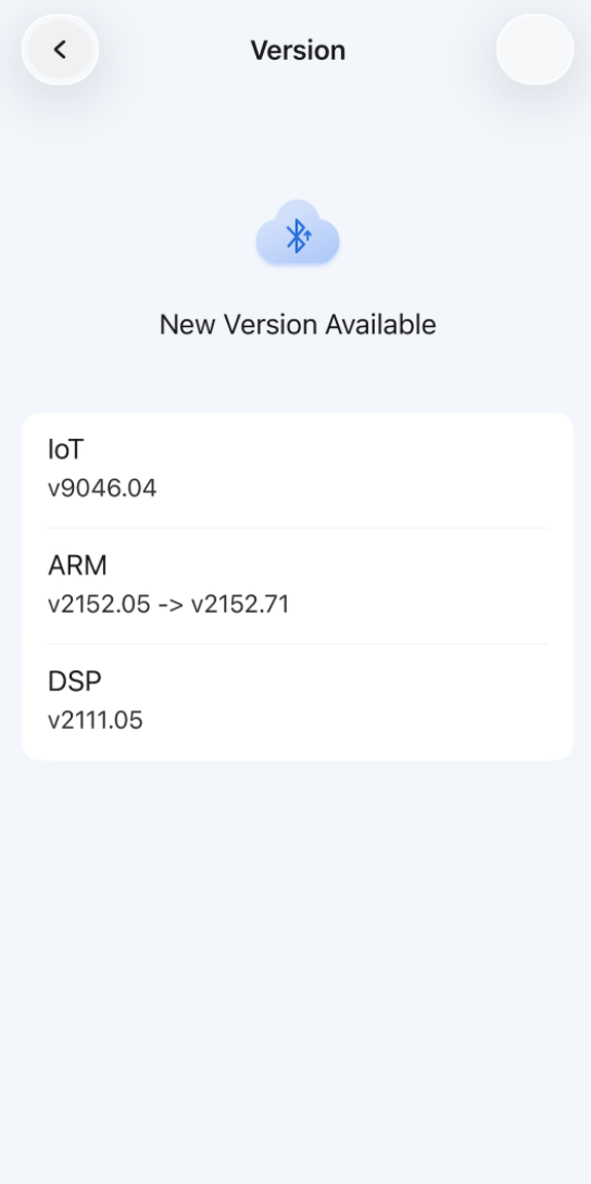

This is what I see checking the app. I can see there is a newer version for ARM… nothing for DSP yet. The app doesn’t give me the option to do anything on the version page like a download button or anything. I won’t know if it works until I run the machine down while monitoring. I’ll update tomorrow
I was able to update DSP and ARM at this point. I charged my AC70P to 100% and was running through tests of all outputs. It went all the way down to 75% with no issues before shutting down again. ECO mode is off, and there were 2 items plugged in drawing about 120W. When attempting to turn the device back on, it repeated the initial issue and shut down again on its own after just 5 seconds. Just turning off on its own no matter if it is being used or sitting there with no outputs on… Starting to think this is a hardware issue and waiting to hear back from my emails to @BLUETTI_CARE
