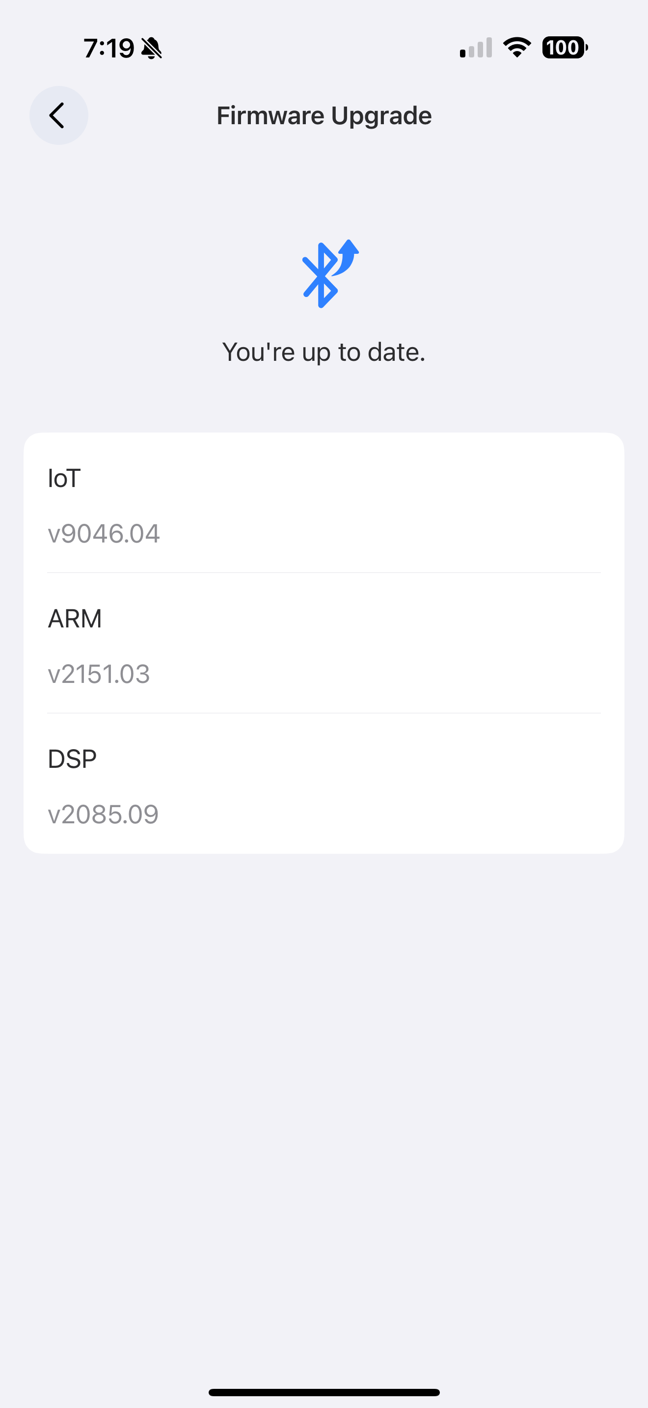

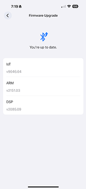

Hi I just got an AC70, can I also get the firmware pushed to my device? I use this as a ups as well
Serial number AC702449000096248
Firmware
IoT v9046.04
ARM v2151.03
DSP v2085.09
Thanks!
Hi @bluetti_jkkwhotmailcom, Now I have applied to upgrade your system to our IT department. They will push the latest version of firmware to your unit in 24 hours.

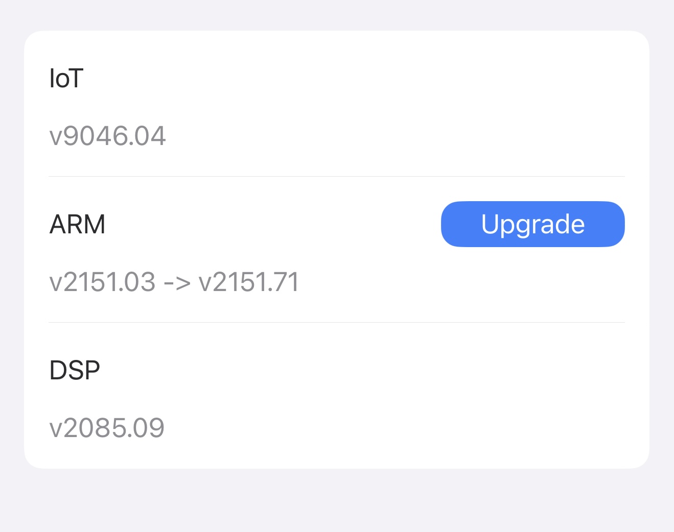

Hi @bluetti_jkkwhotmailcom, We have re-applied to push a new firmware for you. Please upgrade first.
However, the app adaptation is not yet ready. After upgrading the firmware, you will need to wait until the app is completed next month and upgrade to the latest version of the app before the function can be enabled.
I appreciate your kind understanding and patience.

Thank you, I just got it this morning and upgraded successfully. Looking forward to new app! Appreciate your help!

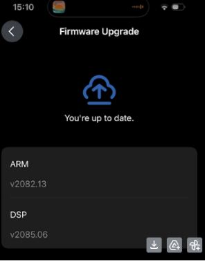

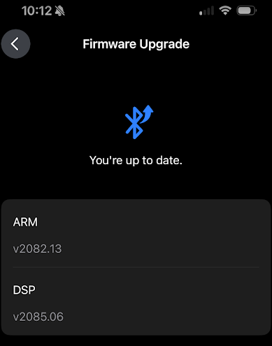

I do not see a firmware update on my AC70, but after updating the app today, I now see something called “system switch recovery” that can be activated. “If you like the system to restore its last output on/off status upon restart, enable this option”. This looks like exactly what I’ve been looking for. I’ve enabled it will report back. I don’t know what enabled it, whether this is a app update or not. I am running ARM v2082.13 and DSP v2085.06
This option should really be available (and likely default on) for all Bluetti units acting as UPS.
Unfortunately, it didn’t work. Even though I was able to enable “system recovery switch” from the app, when the AC70 ran out of power, and I plugged the grid input back in, the AC output didn’t re-enable even though the AC70 was charged to at least 25%. When I check on the app, the “system recovery switch” setting is back to off. I’ve done this 2x already and the same thing happened. It seem that the AC70 didn’t remember that “system recovery switch” has been enabled when it powers down due to lack of charge.
@BLUETTI_CARE Can you help me out with this? We are soooo close…
SN AC702338000845322
Current firmware (no updates available): ARM v2082.13 and DSP v2085.06
