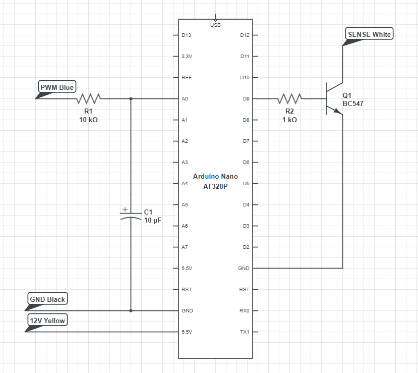

Finally, I made a simulator with Arduino and managed to trick the electronics and allow the Noctua to go in.

I’m still testing it, but here it is :slight_smile:
Sketch:
Code:

…and after that I connected the Noctua to 12V
