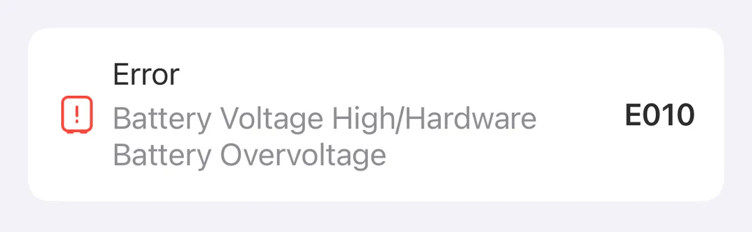

Hi, started to getting this error on my AC70 station
i have tried:
to change charging mode (same error)
to charge from another my bluetti (same error)
to charge from my car (same error)
to update software (same error)
to drain to 0 and to charge again (same error)
There is no disbalance in batteries (i have checked manually)
AC button flashes while that error is there. After reconnecting charge (no matter what method I use) its charging few minutes and then again fall to that error.
Also that error appear when using AC70 as UPS.
Please some one can help me? Maybe advice, maybe some one have similar and fix it some how :frowning:

  1. It is up to date:
ARM v2082.14
DSP v2085.06
(nothing more shown in Firmware Upgrade)
SN: AC702346O (or zero) 00202697
  1. Done twice, nothing.
  2. It is same for all: Eco, Normal, Turbo.
  3. You are not technical team? =O
