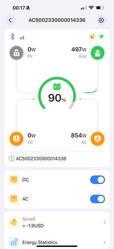

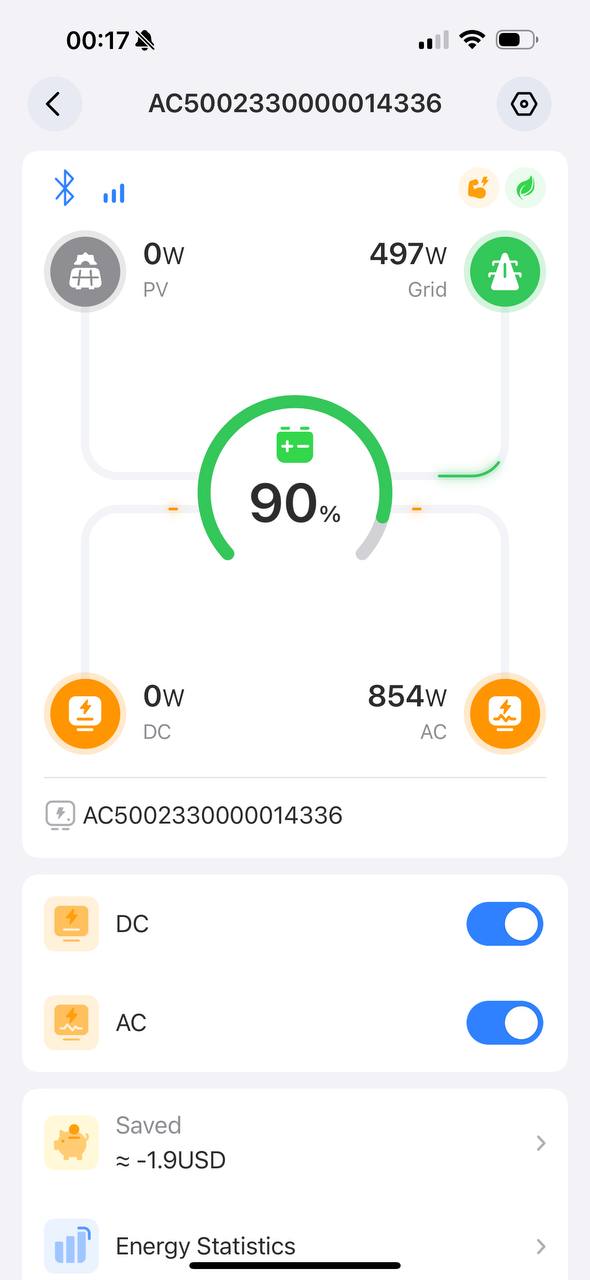

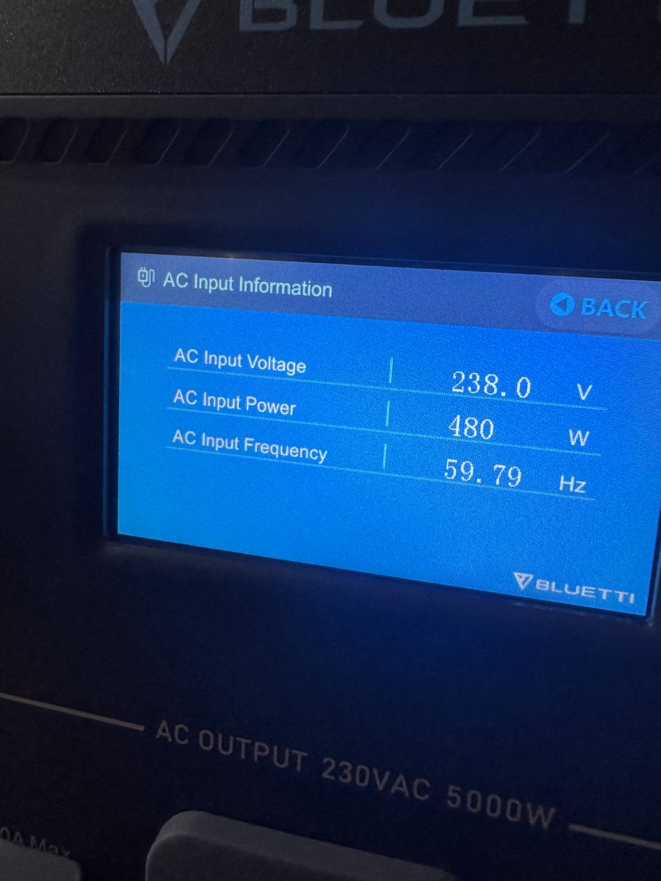

When I first enable PV Priority UPS, the Grid input power shows 0 W as expected. However, after around 10 seconds, the display suddenly shows 300–500 W from the Grid, even though in reality no power is being drawn from the grid.

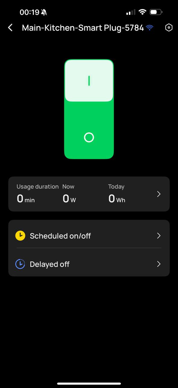

I have tested this by connecting the AC500 to a smart plug that measures actual consumption from the wall, and it consistently shows 0 W grid usage at the same time the AC500 display claims 300–500 W input from the grid.

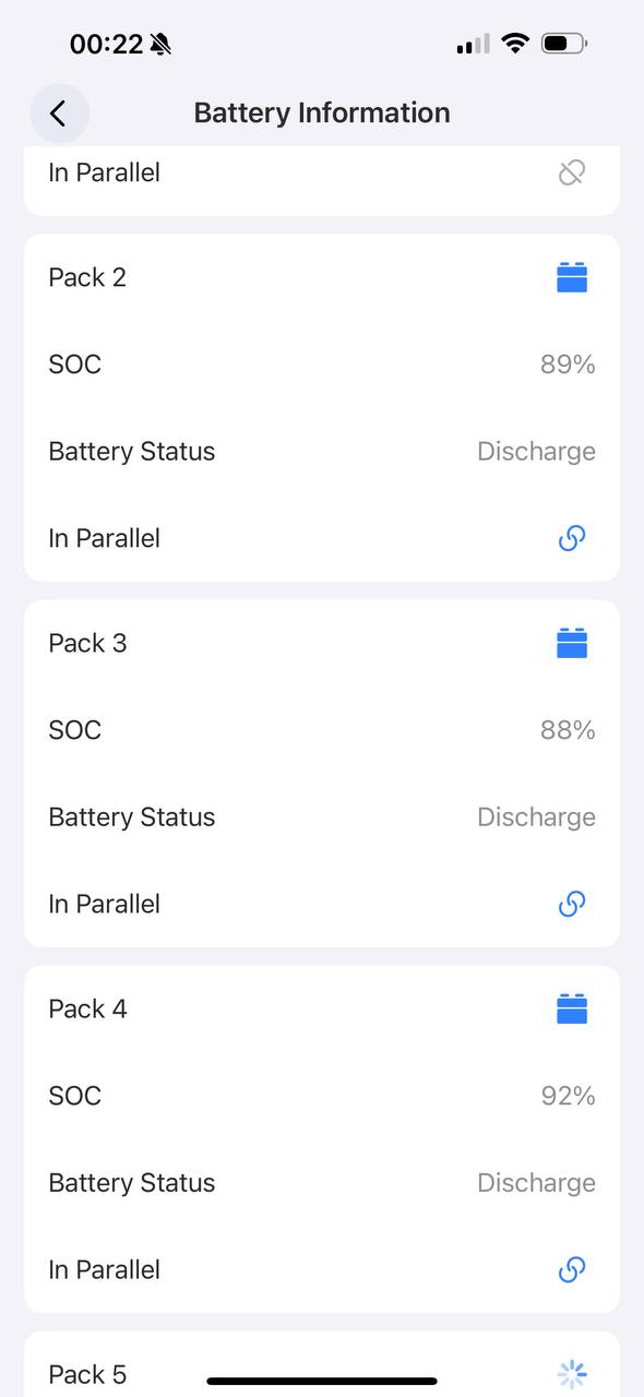

In reality, during this time, the battery is discharging to supply the loads, and this can be confirmed both by the battery SOC decreasing and by the AC output power readings.

  • Why does the AC500 report high Grid input when the actual Grid draw is zero?
  • Is this a firmware display bug, or could it affect system operation?

@BLUETTI_CARE Could you have a look at this? This seems to be some kind of Display error in my Opinion. The Smartplug tell 0W, even when its not right calibratet, it should output something when the AC500 would draw 500W from the grid

The behavior you’re observing, where the AC500 reports a grid input of 300–500 W despite actual consumption being 0 W, may be related to reactive power. Reactive power can sometimes be misrepresented on displays, leading to discrepancies between what’s shown and the actual power draw. Your testing with a smart plug confirming 0 W grid usage supports this observation.
I will consult with our development team to further investigate this display issue and see if we can address it through a firmware update. They have previously worked on similar matters.
