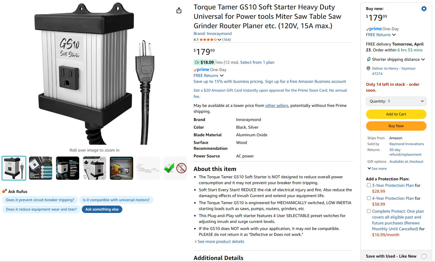

What you should look for is a “soft start” device compatible with the voltage and current of your pump. I have an AC300, and I run my well pump, amongst other things, with it. The AC300 could start the pump fine (120 volts, 1,100 watts running, but can hit 3,000 watts on start-up). When there were lights running and the pump started the lights would dim very briefly. So, I purchased the soft-start device below:
https://www.amazon.com/dp/B07VQ2RZSN?ref_=ppx_hzsearch_conn_dt_b_fed_asin_title_1
That works wonderfully with my well pump and improved the power fluctuation with the pump starting. You should be able to find something similar that works with the current ratings of your pump.
