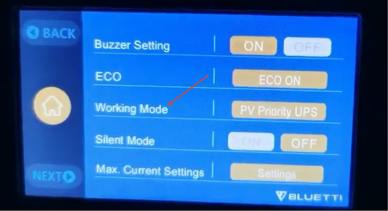

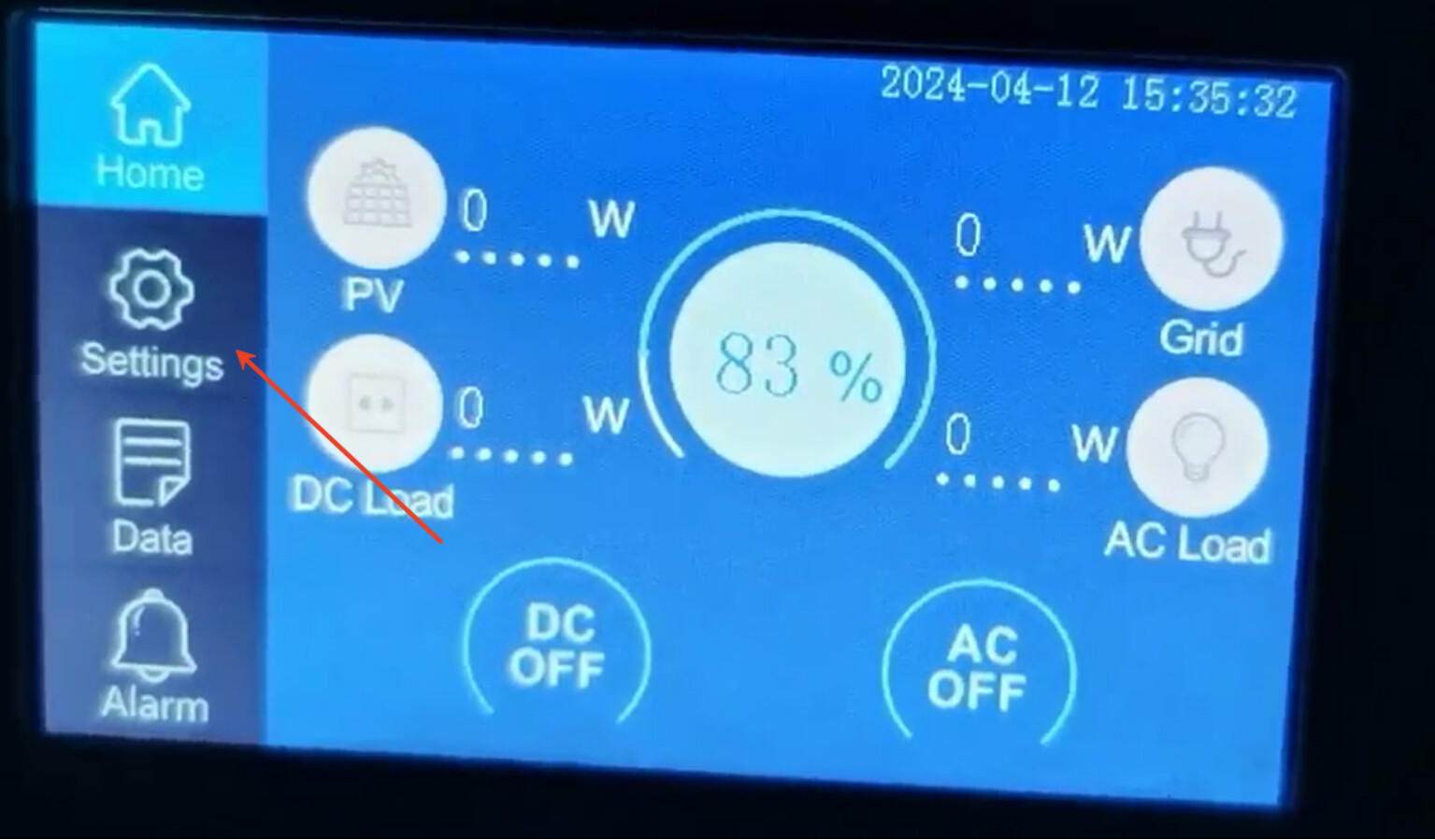

On the AC500 screen:
Tap the Setting icon.

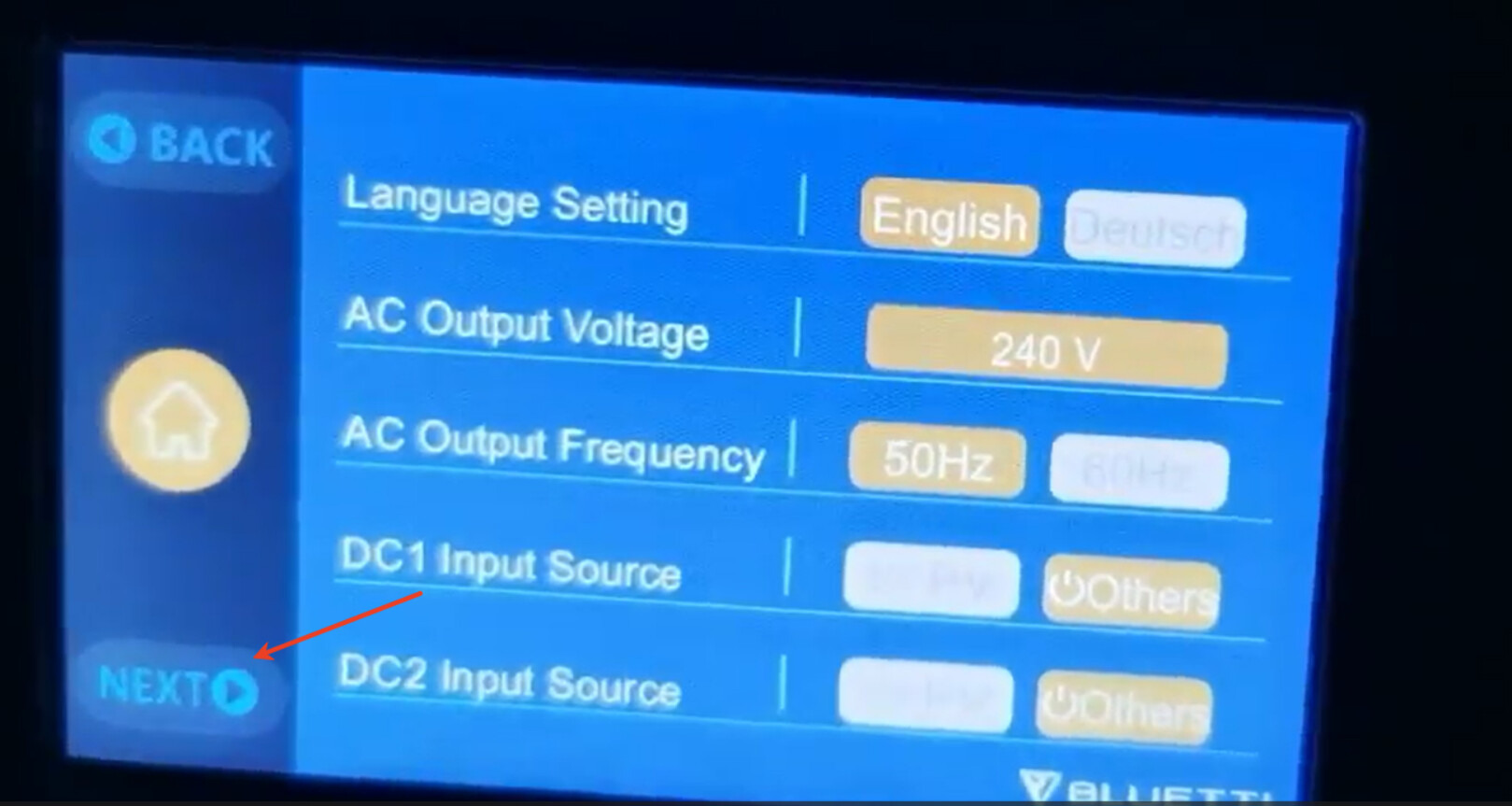

Tap the Next icon to find Working mode.
Select Standard UPS to better adapt to generator charging.
Adjust current settings:
Tap Max Current Settings.
Gradually reduce the current and check if it helps.

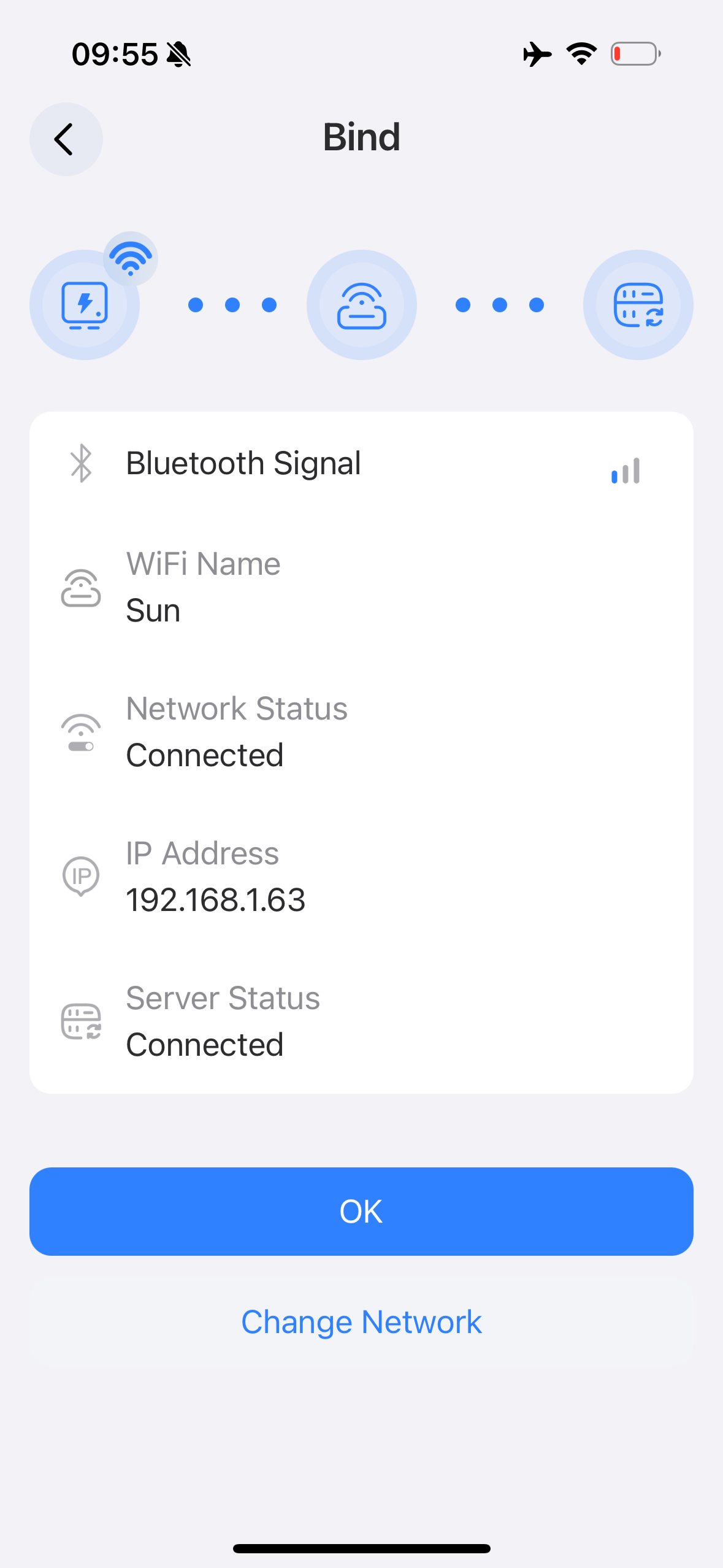

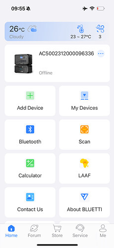

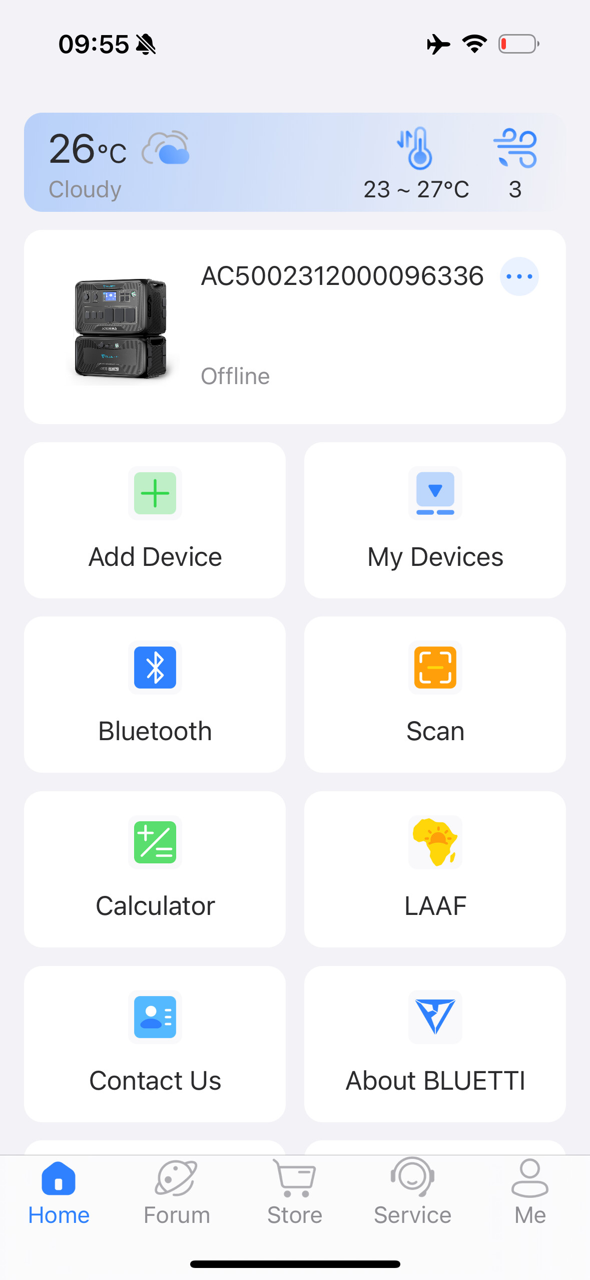

Thank you. I followed the instructions. Got the generator to actually work at 3AMP. Right now it’s charging 680v which is enough for me… it’s charging the batteries slowly but continuously. Excellent. I did encounter another few issues. 1) The bluetti app seams to always kick me out and I have to sign in all over again:
YOUR SESSION HAS EXPIRED PLEASE LOG IN AGAIN.
2) seams the bluetooth connection is rather unstable. I added my home wifi but for some reason the bluetti app says it’s connected to the wifi… but actually it keeps wanting to connect to my bluetooth.
I am using an iPhone 16 model.

When you mentioned “re-logging in,” do you need to log into the app or reconfigure the network? We need to confirm this information.
We have obtained the SN number for the AC500. Could you please tell us your IOT version? Please first upgrade to the latest version, as this can optimize the app’s connection performance.
It seems you prefer to use Wi-Fi to connect to the AC500. In that case, we recommend selecting Wi-Fi as the default connection method in the settings.
