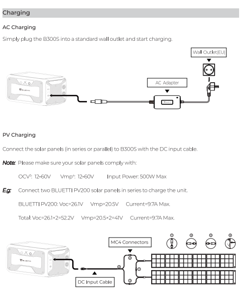

To avoid any misunderstanding (because I believe you recharged one of your B300S connected to your AC500, given that you indicate that “the AC Input charge leveled at 1750W”): your B300S must be disconnected from your AC500 as Bluetti_care suggests. So to recharge your B300S, you must use one of the two dedicated connectors on your B300S (see diagram below).

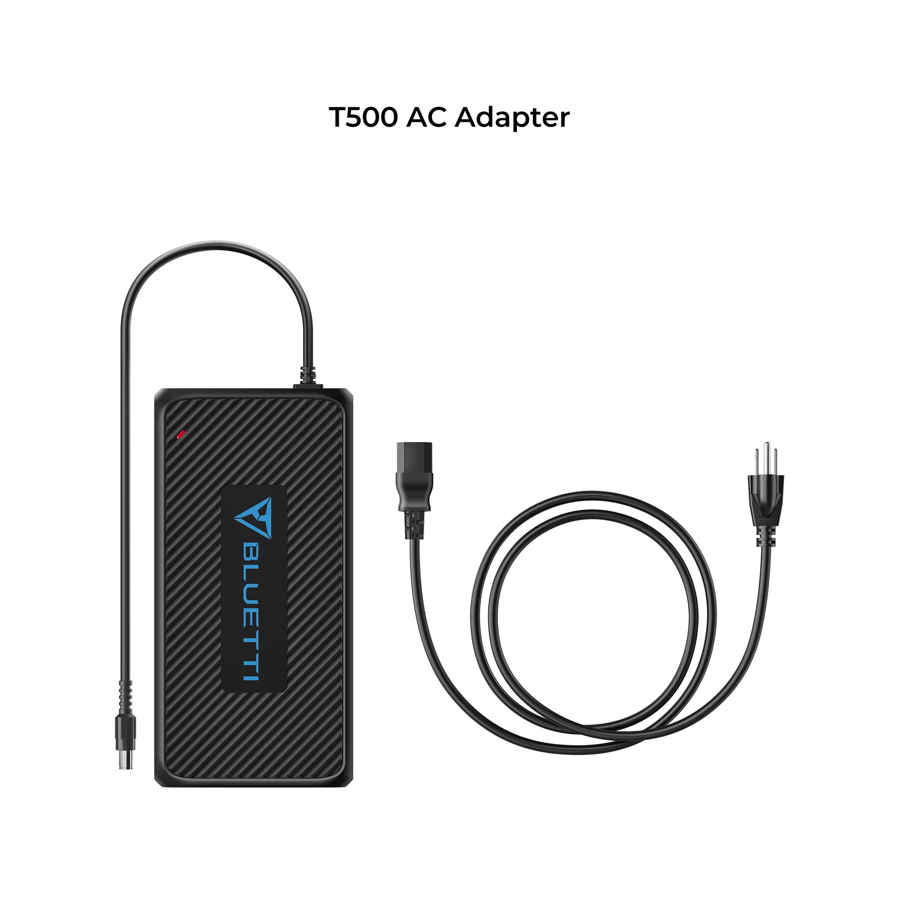

  1. Either you have a T500 (or T200S) AC DC adapter: picture below, in which case you can use the AC Charging method (see diagram below).
  2. If you don’t have this adapter, you can use the solar input of your B300S and solar panels to recharge it (PV charging méthod) but be careful, you need to select panels with an open-circuit voltage under 60V

Snips1, thanks much for your detailed instructions with graphics. I don’t have a T500, but I am now considering getting one. Do you know if you can charge the B300S directly with a T500 while also charging with grid or solar through the AC500?
Hello,
I should let you know that I don’t have an AC500 or a B300s, but I do have AC200max and a B230.
With an AC200max connected to the B230, I can indeed charge the B230 via the T500 adapter and simultaneously have my AC200max powered by the grid and solar. This isn’t documented in the manual, but it works!
I think it should also work for your AC500+B300s+T500 configuration.
In any case, there’s no security risk; you have nothing to lose by trying.
