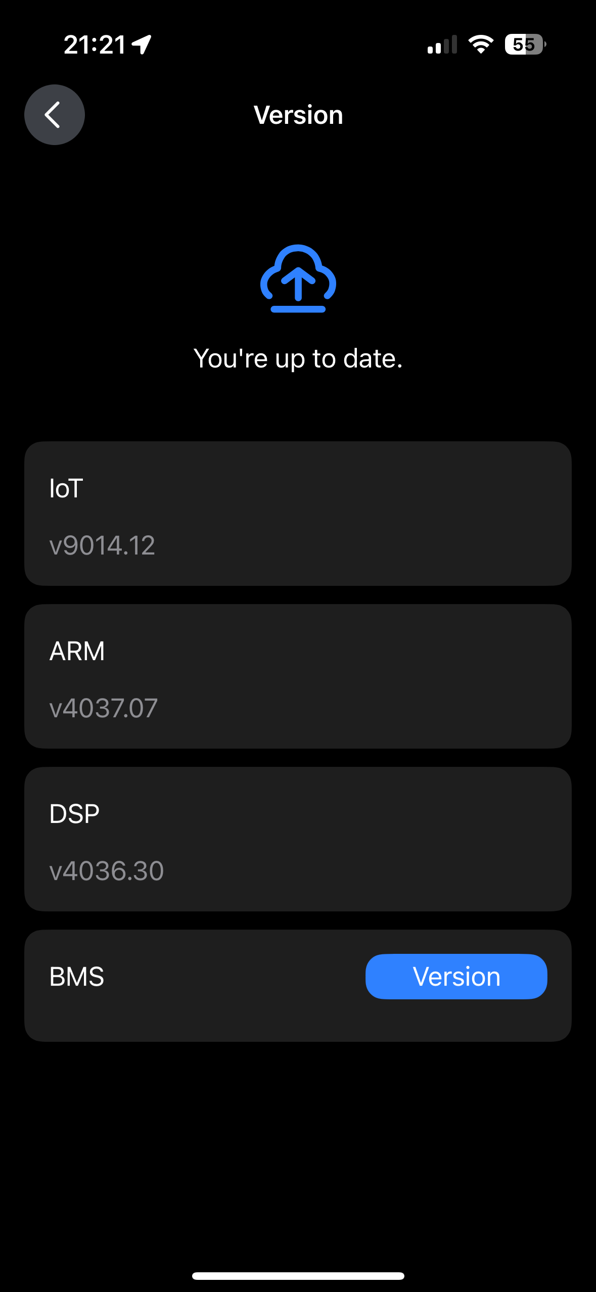

The only difference I see with the software on
My 300 unit is version lot 9014.12

Hi @Selfmadestrom, We attach great importance to your feedback.
@Ktt’s explanation is correct. Generally speaking, upgrading the new IOT firmware can indeed effectively improve the WiFi signal.
However, we have found that the batch of your AC300 does not support IOT upgrade. If you think this significantly affects your usage, we can replace it with an AC300 from another batch. Do you agree? Please contact us via private message to arrange a follow-up on this matter.
