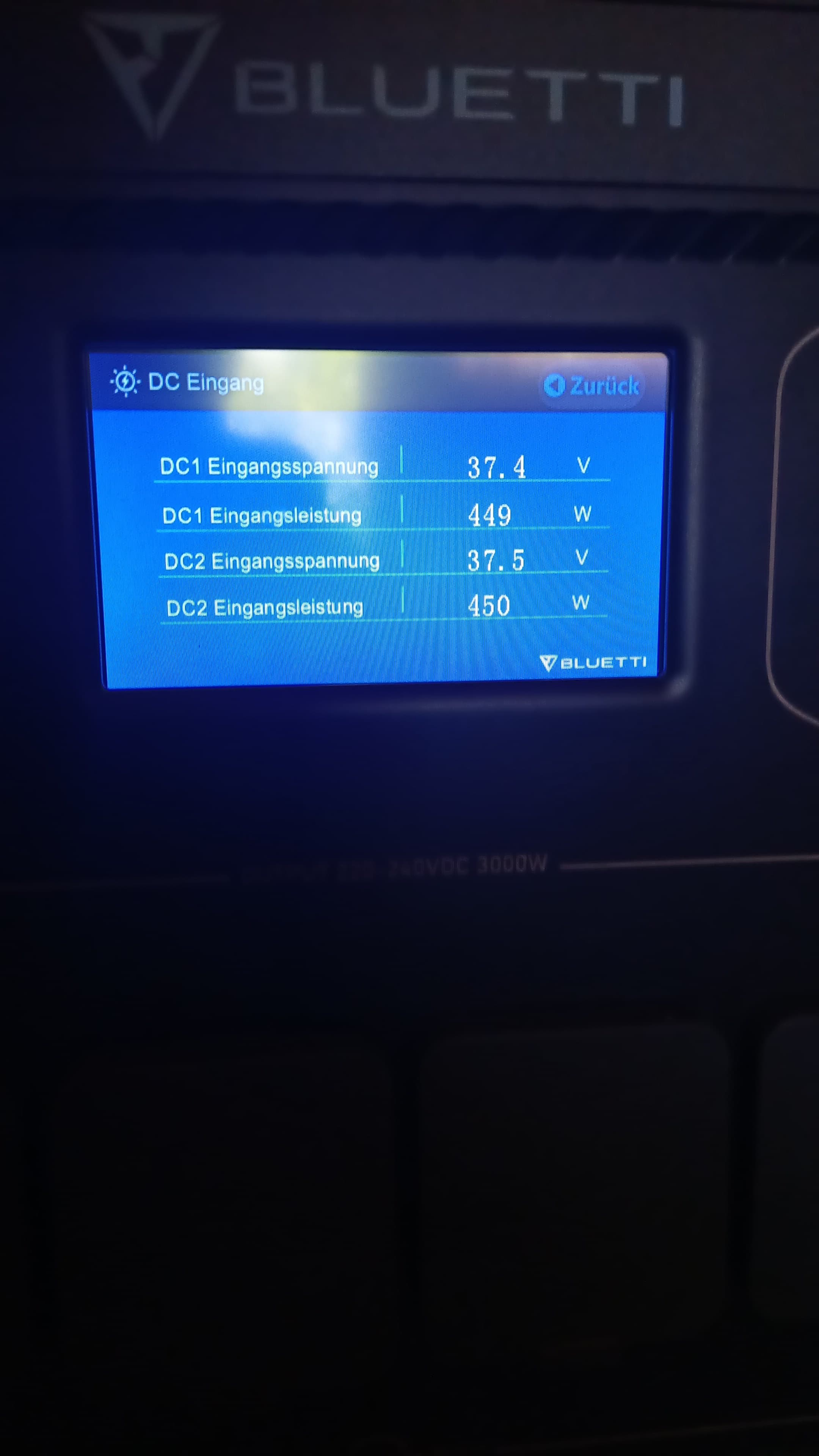

does anyone may know why my bluetti “only” charges with 450W on each tracker ?
i mean it should support up to 2400W and my 4 panels should be able to get to 505W but my AC300 shows no more than 450W on the screen.

The Wattage shown on any Bluetti power station as an input, in your instance solar, is what it is receiving. Without a Watt meter inline and between the solar panel/s and the AC300, one can only assume that is what your panels are producing.
The primary thing to understand is and I will give my home roof top solar panels as an example;
My panel array is 6.6W, made up of 15 panels each rated at 440W = 6,600W. They are east/west and split either side of the roof and since installation have never produced more that 5kW due to their orientation. The inverter is 5kW and therefore getting it’s maximum input/output.
However, here in Australia, the above 5kW output is in summer time and it’s currently winter, so I am seeing output drop to 1.5kW (less than 25%) on overcast days. More…
With a 505W rated panel (that is a laboratory tested figure at 25 deg C (77F), you will rarely if ever get that output in the real world. Angle of elevation, orientation at different times of the day, ambient temperature, panel temperature, cloud etc all affect output. That you are getting 90% of rated output, is not something I would complain about, even as a maximum production.
Other things such as quality of panel, length of cable relative to voltage drop also lower output. without actually putting a power meter as mentioned above, when the panel is connected and under load to the AC300, the panels actual output is not known.
In my opinion, the AC300 is not the issue, as much as, what the panel is producing.

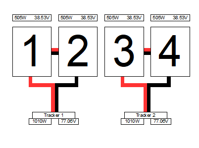

So if i read that right on the Dealer page, up to 150V and 1200 on each tracker.
My panels got 38.53V times 2 since i connected 2 panels on each tracker, which means to each tracker is a connection of 77.06Vmp.
It supports up to 1200W on each tracker and my panels sum up to 1010W.
So i should be well within the recommended range.
Please correct me if my stats are wrong here.
Forgot to mention, the wires are less than 10m from the Y-adapter to the connector on the station
