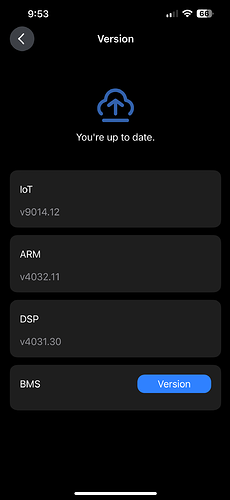

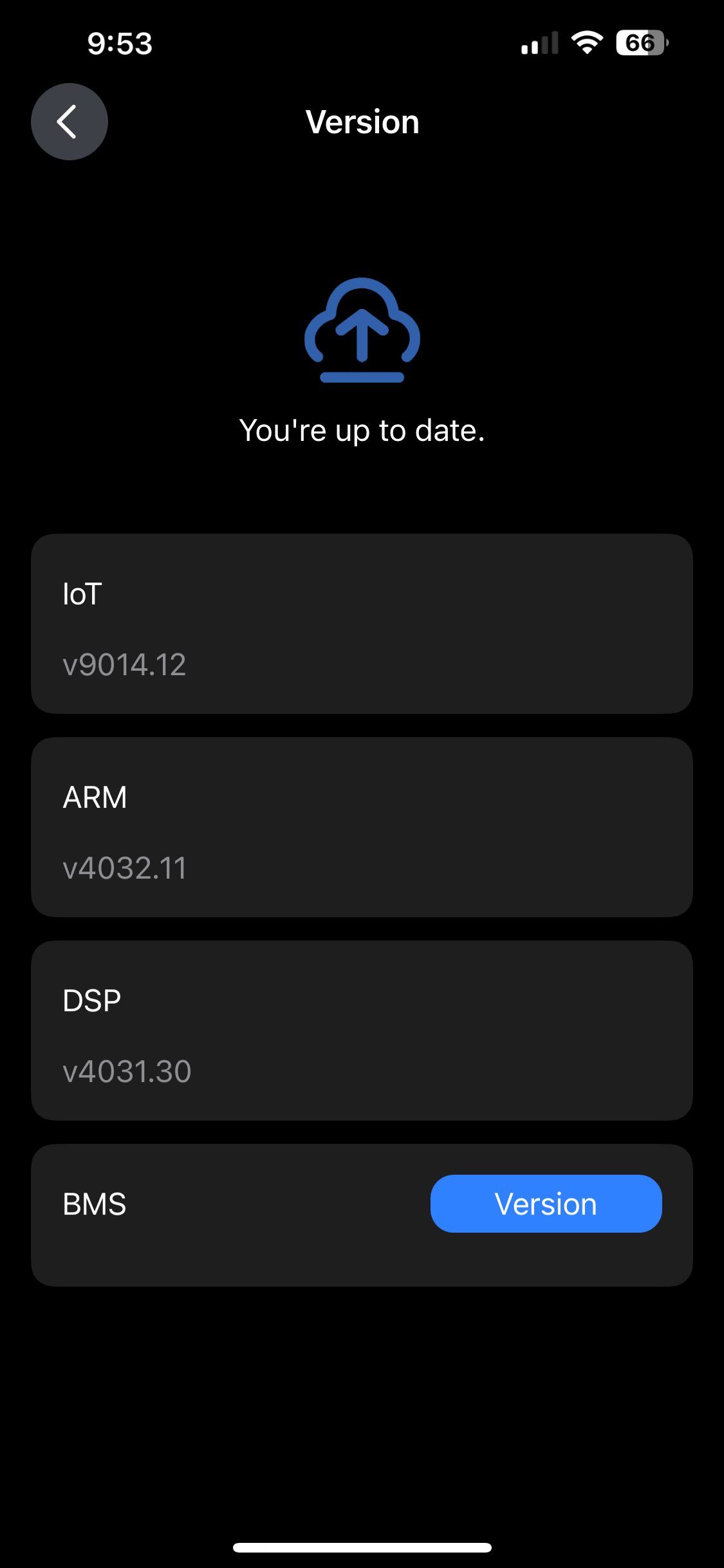

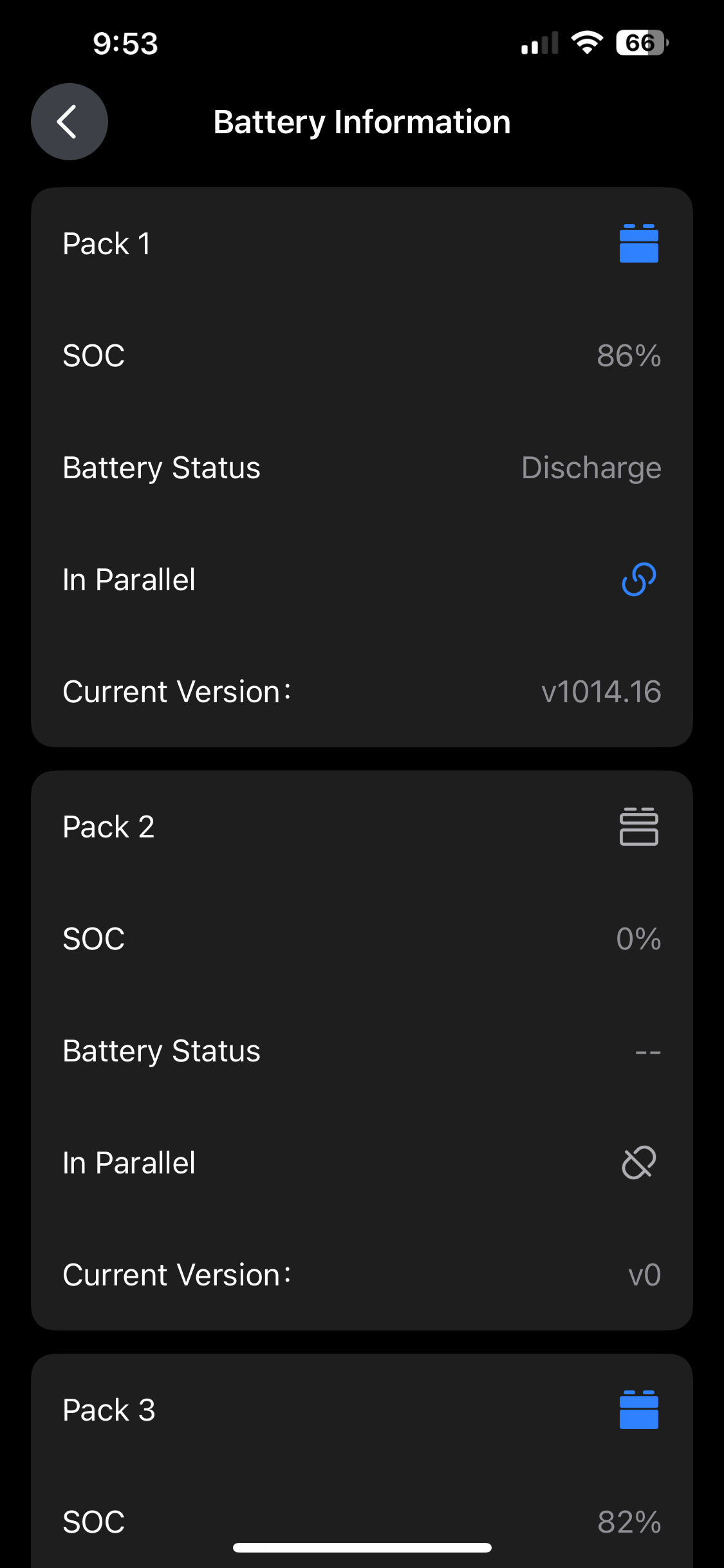

We notice that your IOT and BMS are not the latest versions. Have you received the pushed new firmware? Please provide the SN number of your AC300. We would like to know which model of battery pack you are using? Also, has your app been upgraded to the latest version?
After that, please disconnect all loads and then restart the unit. Does this help?
Thank you for checking the previous cases. Our solution to this problem is the same. Please troubleshoot according to the above steps. Upgrading and restarting without loads can solve most cases. However, if the firmware upgrade is ineffective in a few cases, you need to contact customer service to arrange warranty service.
Hello BLUETTI_CARE,
I have an iPhone (latest iOS) and there is no update to the Bluetti, Just Power On software. I have no new firmware for any of my hardware, versions as posted above. If there is an alternate method to perform firmware updates please let me know. As for the model of the B300, it is the B300 original unit sold by Bluetti, P/N 17.0301.0945-02A2.

Please connect with bluetooth to your unit and check again.
It also take about 24 hours befoure you can see it.

Hi @mjl64, We have checked and confirmed that all your firmware is already up to date. If restarting the device after disconnecting all loads still fails to resolve the issue, the only option left is to contact customer service for repair.
